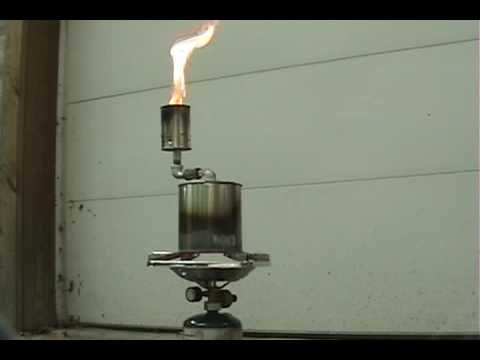

My theory was that the dirty producer gas we created by externally heating a container of biomass could be cleaned up by running it trough your charcoal gasifier. The hot charcoal should be enough to crack the tar molecules into short chain molecules suitable to fuel an engine, if we filter it up through your gasifier.
Why do this when charcoal itself produces clean producer gas? Because a setup like I’m describing would allow you to make clean, engine-ready producer gas from wood, grass, weeds, plastic, used motor oil, waste paper/cardboard, animal/human manure, and agricultural waste, to name a few. The feedstock you can use would be readily available in most parts of the world and plentiful. We could stop throwing most of our trash into landfills and turn it into fuel to power our lives.

This is a link to a YouTube video that showed producer being made with an external flame. This is the video that got me started down this crazy gasify-anything rabbit hole. I wanted to put whatever material I wanted in the chamber, heat it over a rocket stove, pipe the smoke into a reduction chamber inside the stove, and get clean producer gas out. My plan has been adapted as I learned more, but the basic idea is still what I’m after.
I’ve learned a ton along the way and I’m sure I’ll learn a ton more before I’m through. If we all share info and ideas, we’ll accomplish big things much sooner. Keep an open mind and stay curious. Always watch to see what info can be combined and always pass along information to others who you think can use it. This is how we can get it done.
