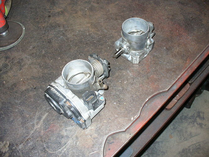

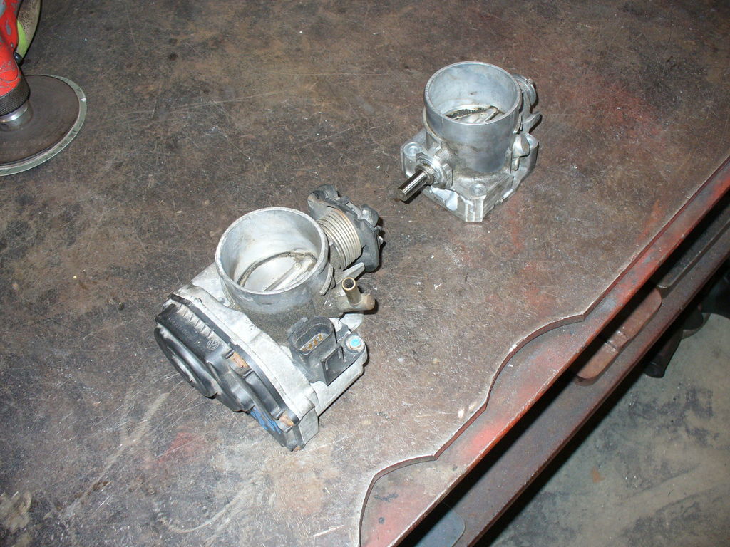

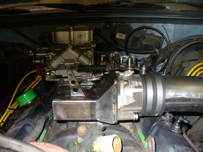

Thanks Carl, I happened to find 2 VW 17/8 throttle bodies.
With some machining to get rid of the electric motor & gear box, these seem to be very well made units. Will make a manifold on the intake tube & attach air cleaners directly to the throttle bodies with no extension tubing.

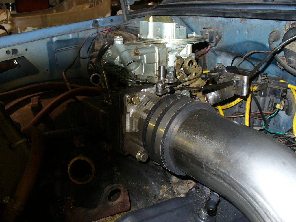

Have the wood gas throttle & 700r4 TV cable working. Throttle & cable both adjustable.
“With some machining to get rid of the electric motor & gear box, these seem to be very well made units.” Peter, you amaze me!! How do you find these gems, and two at a time?? They are diamonds in the rough, and you bring out their re-purposed qualities. I salute you my friend.
Edit: What year VW? Oh, why do I even ask, I don’t think they have VW’s in Arkansas!
Peter,
Nice looking work there,
slap it on the mill and take off the stuff ya dont need, luv it.
I hope to do the same when I get that far. I wish I could look at a catalog that had all the throttle bodies ever made so I could pick the one that would work the best.
Thanks Carl & Wes,
No idea what year ---- know it is VW by the stamping on the unit.
Yes, a throttle body catalog would be very handy ------ save many hours of searching!!
Hey Wes selection is easy - use what is readily available salvage with the closest bore size.
Currenty here Chrysler/Dodge/Plymouth mini-vans get the nod for air control valves. Nother place it might be Honda or Suburu. It’s all good man.
Steve,
The reason I chose those particular throttle bodies is the very graduated ramping under the butterflies. Typical for Germans to take a working piece & make it a little better just because they can!! This is a work ethic that actually existed in this country at one time.

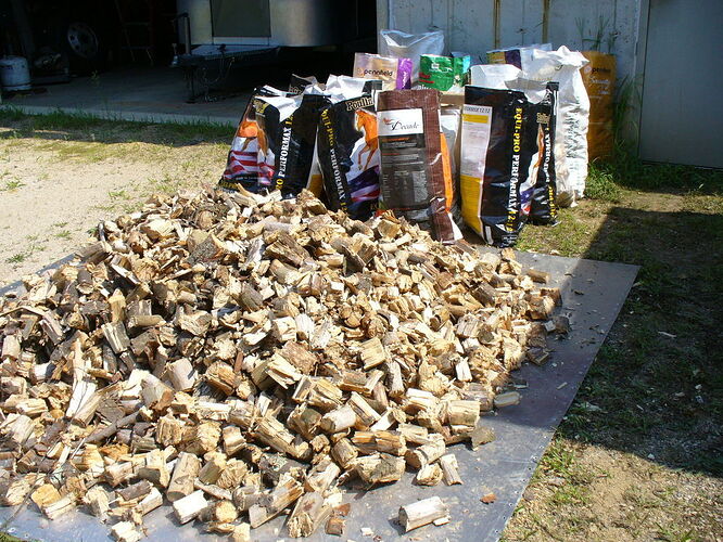

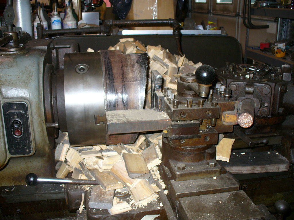

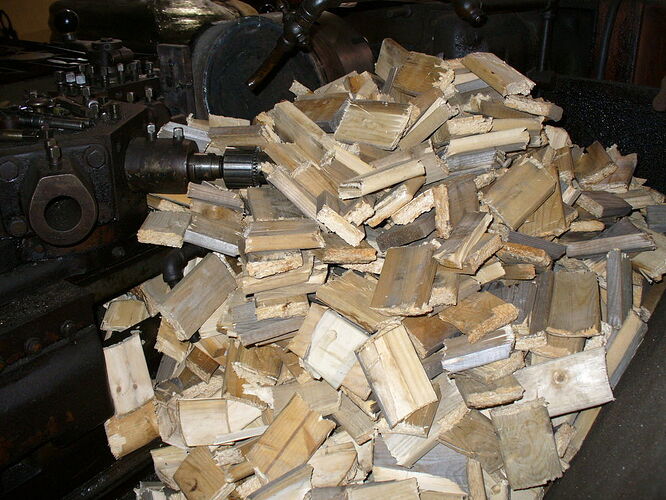

Been chunking all different forms of fuel. This is 1x3 strapping ----- about 10 — 12 minutes.
Have chunked round & square hard & soft wood up to 3 inches ------ dry & green does not seem to make any difference. Found construction lumber makes much less of a mess than trees. Also found that a dull blade shatters the wood better than sharp. When I sharpened the blade it looked like a saw cut ---- don’t know which burns better in a gasser.
Drooling Peter. Just drooling.
Better than having your own oil well Peter!
That is pretty damned awesome!
I’ve heard that a sharp cutting action is better than a dull crunching action for various reasons.
Chris, you can drool ------ just don’t get the wood wet!!
Don, that is the truth.
Brian, What would those various reasons be? Seems the puffed up wood may dry & burn better. Sharp or dull ----- no difference to the lathe cutting through.
The ones I can remember off the top of my head being: 1. Dull-cutting wood crushes all the wood capilaries closed so it can’t “breath” and exchange gases as easy; 2. Splintering wood changes the surface area-to-volume ratio by 100-fold which throws off the balance of where the gases get formed/exchanged; 3. Splintered wood cooks down to a fine choking dust instead of nice solid chunks of charcoal with good gas exchange/flow.
I’m going off collected second-hand knowledge so hopefully someone with first-hand knowledge can confirm or correct my findings, as needed.
Thanks Brian, maybe Wayne can take a look at my pile and chime in on this one.
