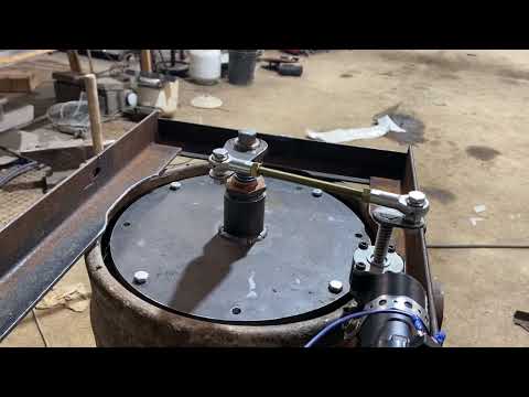

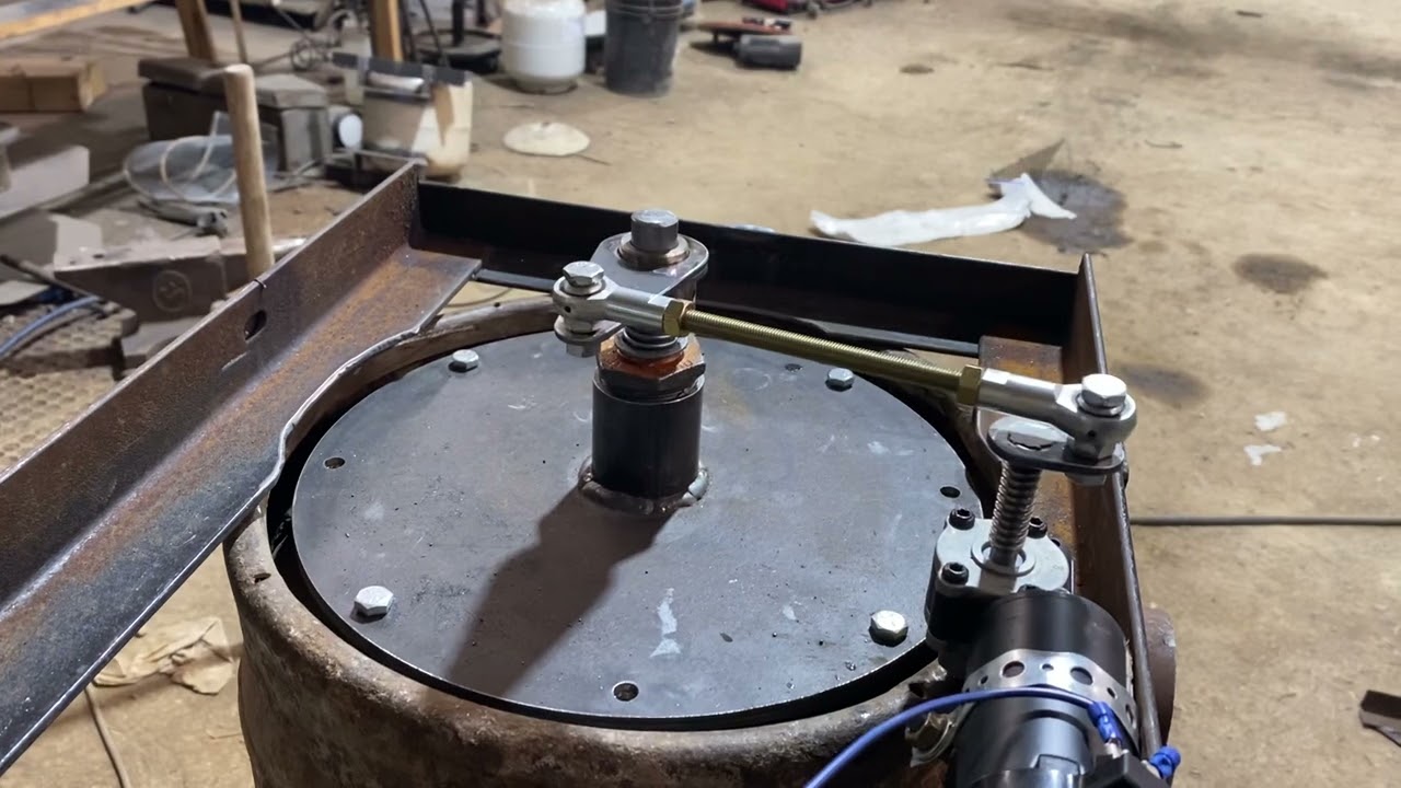

Finally did some work on gasifier, stupid work and laziness get in the way, made a filter housing and grate motor
Here is a short on grate motor, SteveU does this look ok?
Yep. Yep.
