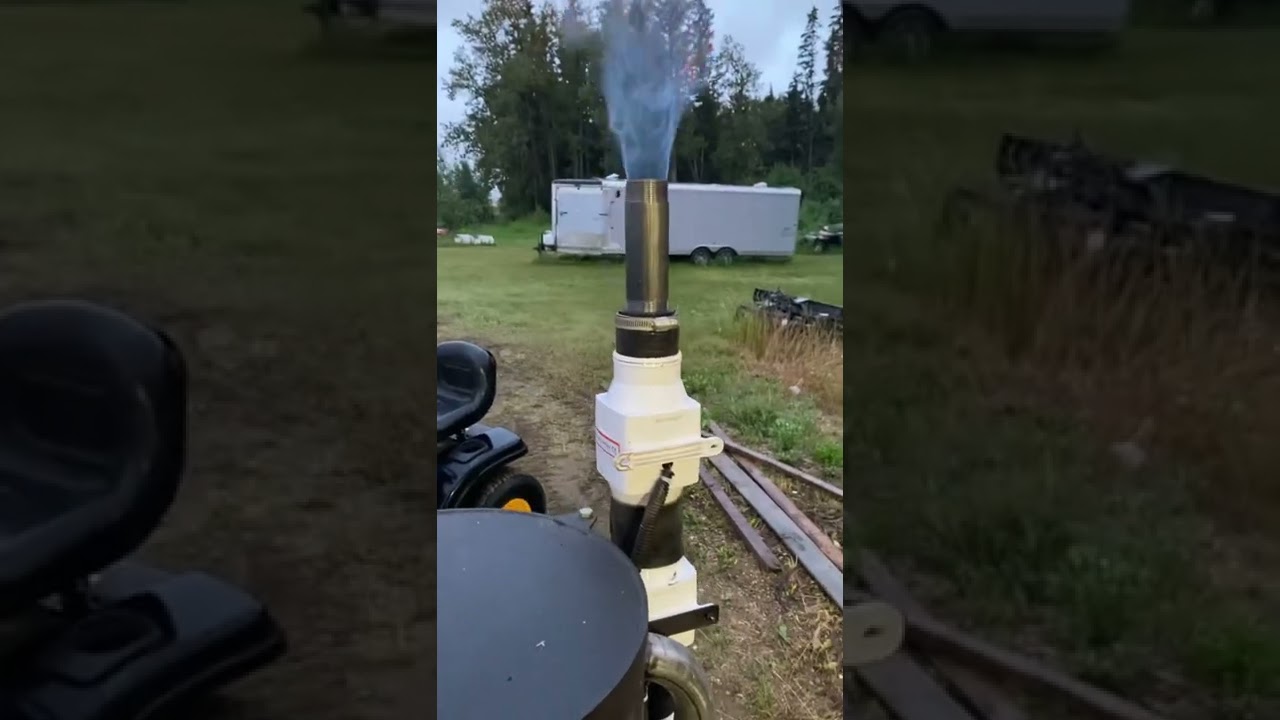

Ya Tom, it’s kind of ugly now, but after I make sure it works good I’m gonna insulate it more on gasifier and paint it.lol
Well I ran the gasifier again tonite and thought I’d try it on my old lawn tractor with a 19 hp 1cyl ,prob to small but it worked .
Then I flared it before I shut it down
Ps. Tom I splashed some paint on it😀
Well, that’s just excellent Dean. Your gasifier certainly earned it’s paint. I’m sure Ben Peterson would be proud of you.
Hurrah for you!!
Your engine sound nice. Must still have good compression.
You did appear to gasifier internal size this for the smallest 500cc version. My 17.5 hp Kohler Command’s, out of the old riders are also under, but near-500cc. Once you RPM’em up and load them down like in a 8000-9000 watt generator you will be fine.
And what will help is the outer system insulation wrapping with sheet metal skin upgrade.
Keep the bleed out heat inside working for you. Not your job to heat all of Canada, eh.
