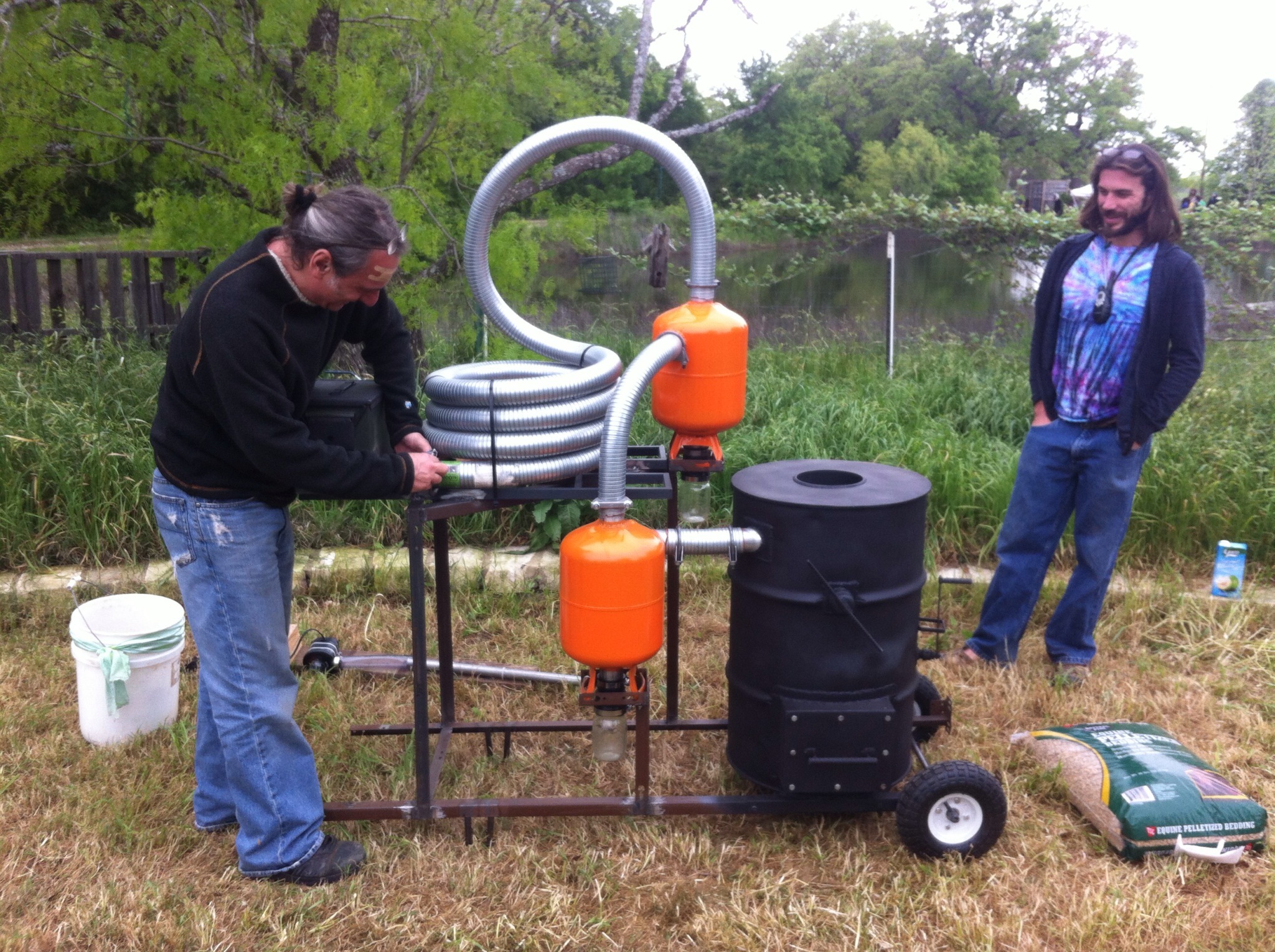

First off for some background, my friend and I built a small gasifier as a standalone unit to power a generator. We’ve gotten to producing gas and successfully flaring it (yay!) but are still working out the kinks and honing our filtration so we don’t gunk up a motor. This is our first step, the next being applying it to our vehicles… which is what I actually want to ask about right now.
