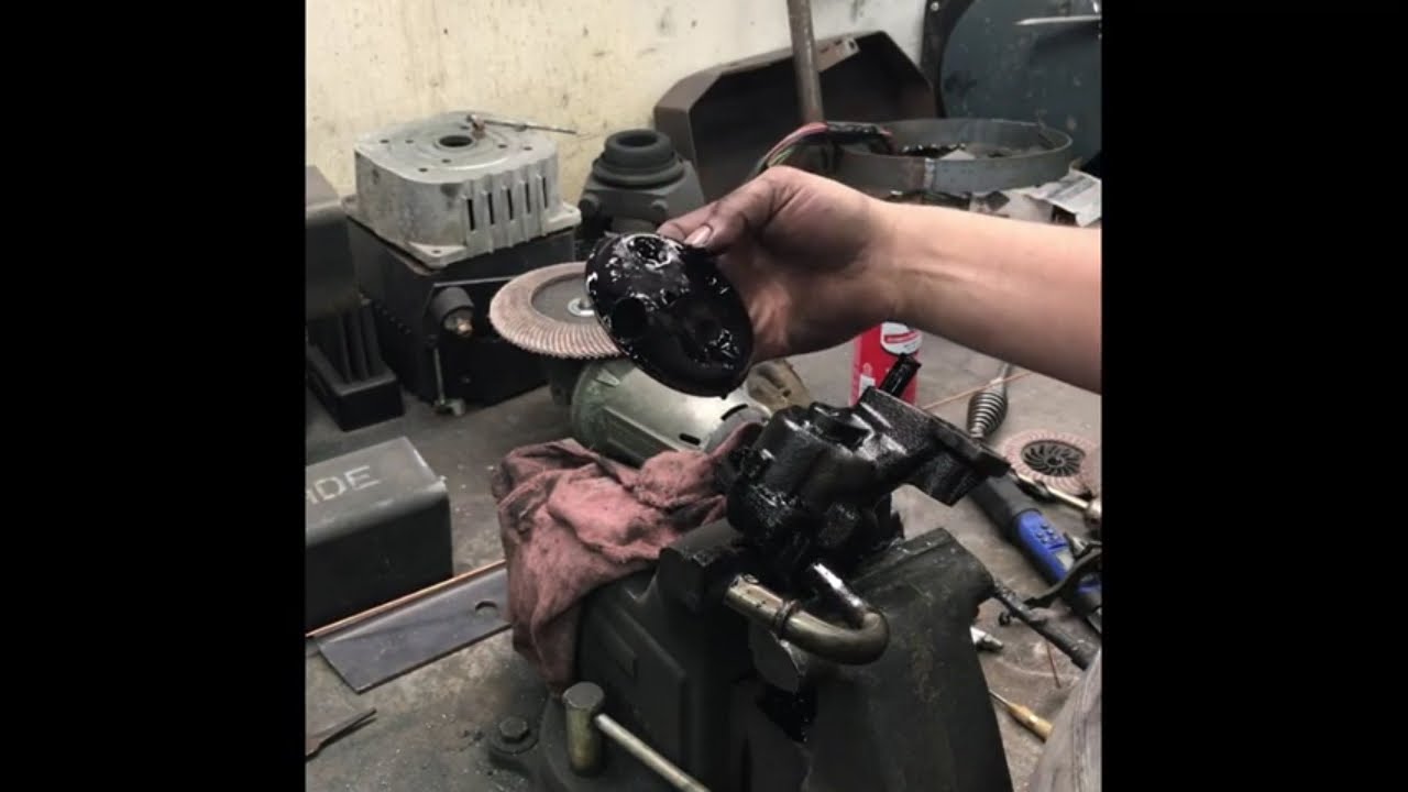

Hey @tcholton717 here, have some more nightmares about filthy carbs
I watch your videos on the 6 foot TV one of our sons forced on us. That really ramps up the nightmares. I watch early and try and get the horror out of my mind before bed time.
Thank you for telling me this Marcus, Iāll probably change the oil in my car again, although itās not so long ago, itās this kind of thing Iām so scared of with dirty gas.
If this is dirty gas related and itās getting past the rings somehow, Iāll have to work on filtering or cleaning the filters even more often. This was about 5500 miles since the last lube oil filter service
