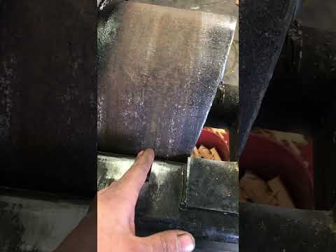

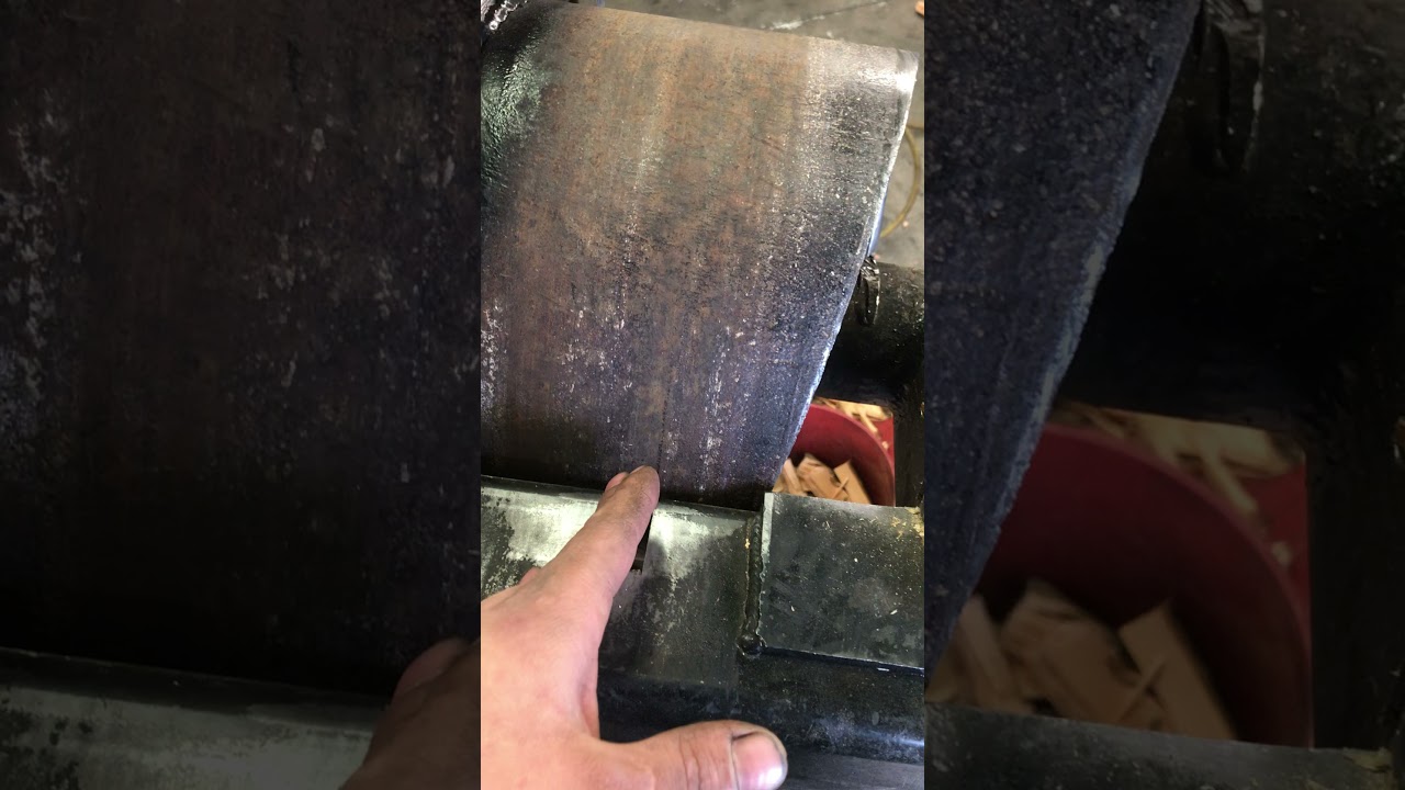

After I made the chunker and used it a while I had to go back and cut some off the cutter wheel so I would have more time to get the wood set into place.
I noticed right there in the video I don’t have enough time to get the board in and it will get opened up like yours. Once I did all the math I should have come out at 60 rpm at the cutter but by a rough count it’s is about 45/50 rpm and still not enough time so I’ll go back in and open it up some like you did

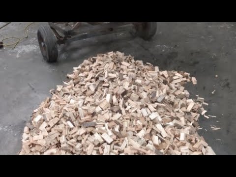

Well the pile was about chest height when I started and the chop saw made its way lower as the pile dwindled
typically I have a forklift on hand and set up a comfortable work station on it but not this time

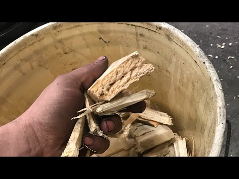

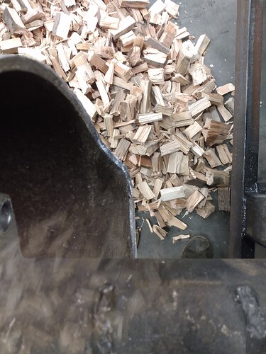

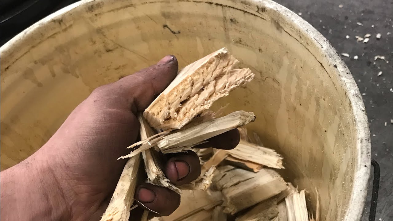

I re profiled the cutter head and opened it up quite a bit, also put in the hook I talked about in the last video. I had already ran the chunker a bit right before I did these modifications so I could see and feel the difference. Initially the hook section was way to aggressive, if it hit a hard piece of wood it would bounce the trailer tongue up off the ground, so I went back in and softened the corner up a bunch. Small pieces are cut with a heavy downward force, larger pieces get a side cut going and then lopp
ed off from the top down like I was expecting. Only stalled on one heavy knotted up piece and belt slipped just like I had hoped it would. Pallet supply is looking thin for the first time in a while and the prepped chunked fuel is stacking up!
