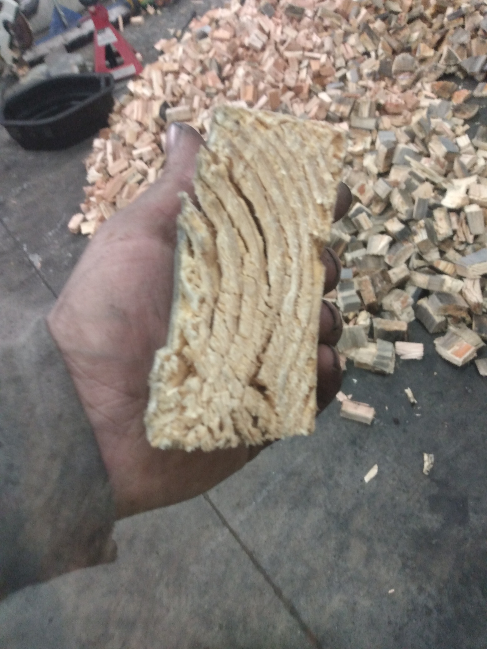

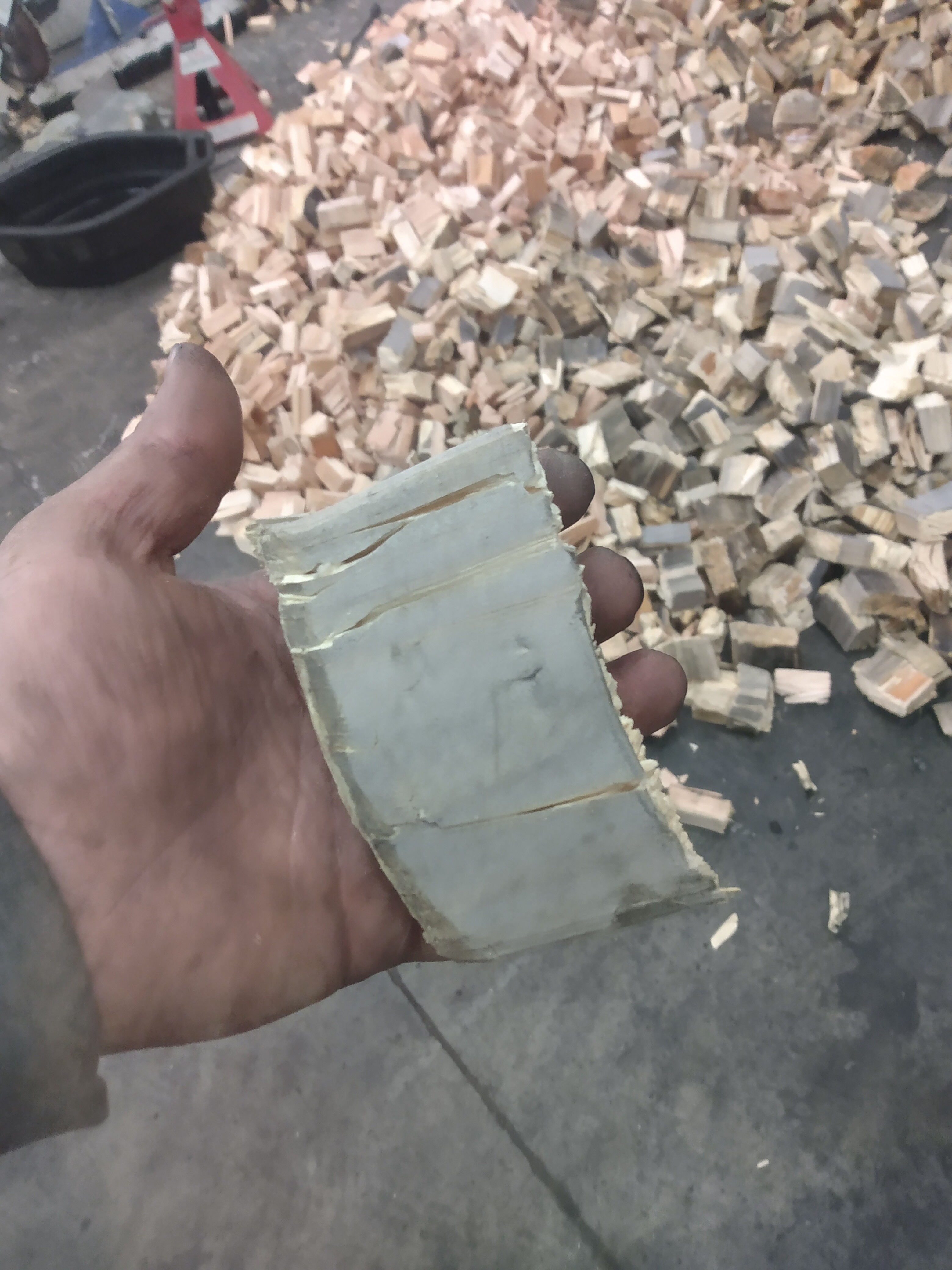

Huh, who’da thunk that problem would be so simple to solve…

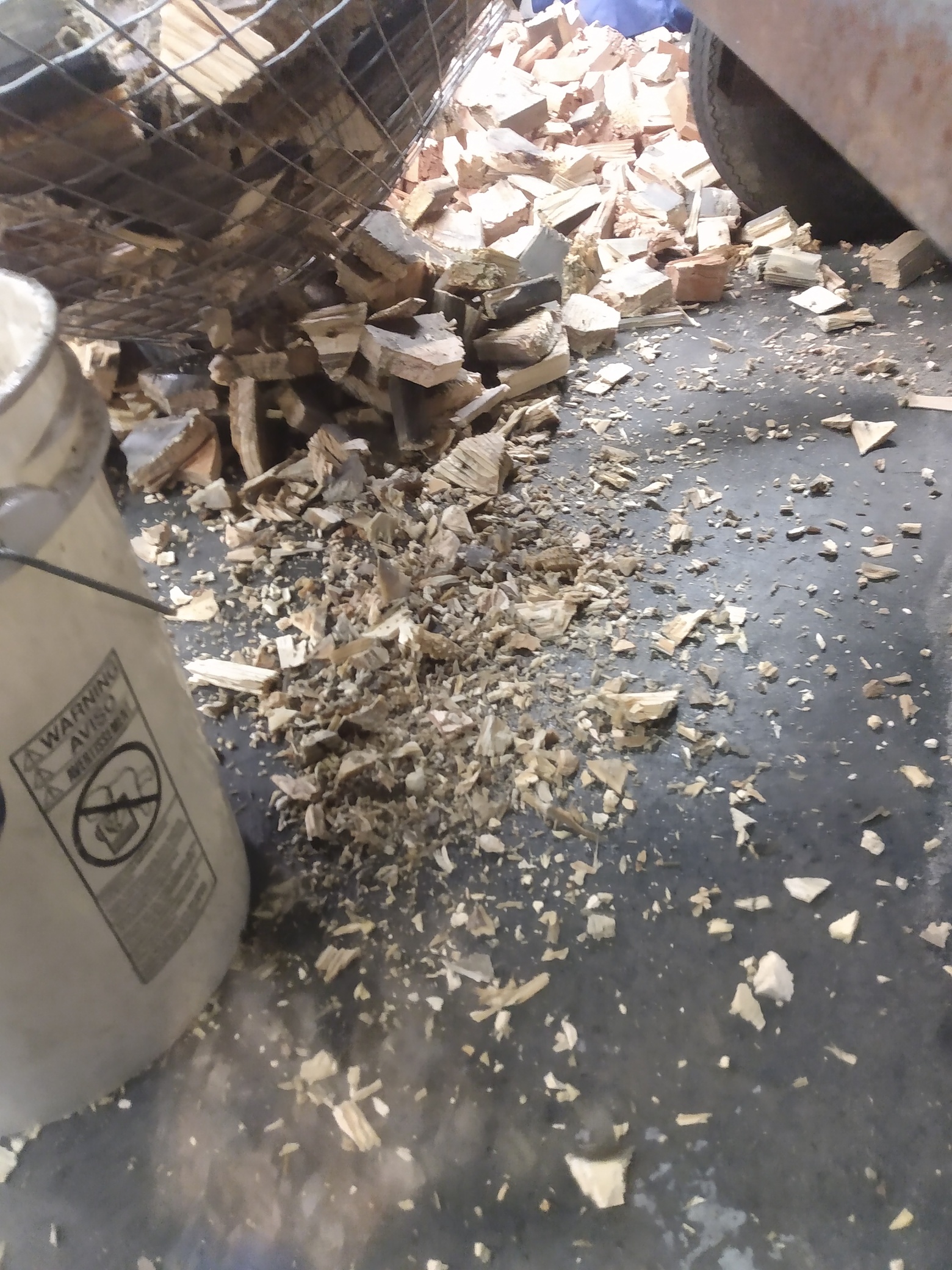

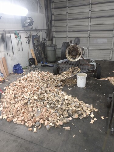

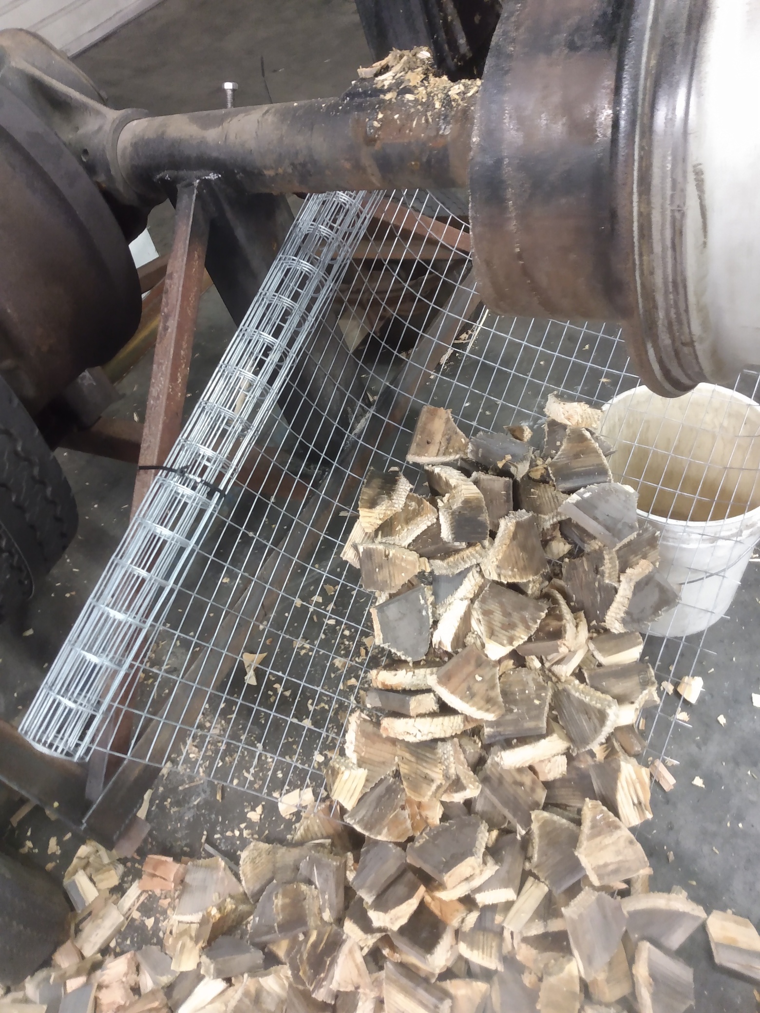

Just keep the pile of small debris swept out, and the chunking motion gives a very nice shaking to the wire that sifts it all out
Oh if it’s a little damp ( I sprayed the wood pile down with the hose) the chunker will walk through a pine 2x4x8 like nothing
How has the cutting edge held up?

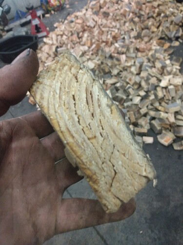

Those shattered chunks are perfect for a high performance fuel.
The dry stuff is hard on the edge, it rolled over a little. Nothing a few quick strokes of the file won’t clean up. Little bit damp treats it way better!
I just kept grinding the rolled edge off until it stopped rolling over.
Made a more thicker edge still cuts good.
That’s exactly what I figured would happen once the softened face from the torch cut wears off it should work harden the steel and hold the edge
