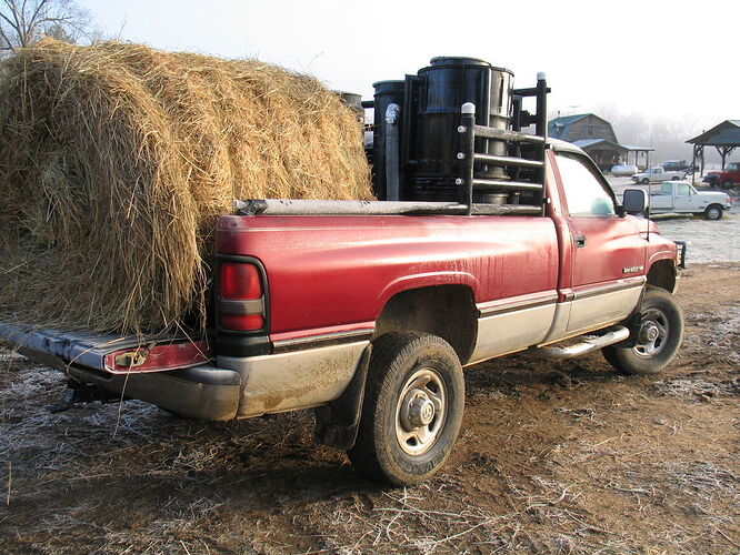

Some gasifiers are more dangerous than others. I’ll leave you with this picture, a large bale of dry hay on Wayne’s truck, not 3 feet from the blazing inferno. Every day, all winter long.
Hello Eric,
On the daily basis I haul a thousand pounds of bone dry hay within 18 inches of my gasifier. In the hay field when I am cutting and curing I am driving over bone dry hay near two feet deep.
However I wouldn’t want anyone in a new car to be in the hay field because there have been many fires started in this area usually in the fall from their catalytic converters.
I know of no system that would be fool proof but the examples you give should be the operators’ responsibility.
