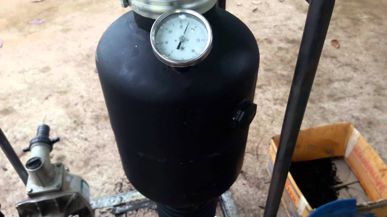

I watched the video and then looked into the motor and drive system and found it very interesting. Put the engine on the boat, catch some fish, etc., take the motor out, go home, run generator, little tractor, lawn mower. One engine, five machines and of course a small gasifier run unit, which I haven’t found yet. There are some interesting vids on youtube on the drive system.
