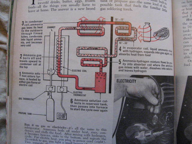

From what I understand, air conditioning based on vapor compression of refrigerants is the most efficient way to transport heat, and those which have a ground source or water source heat exchanger are the most efficient of these.
This contrasts with absorption cycle air conditioners, such as ammonia-water systems, which are about 80% less efficient, but are more easily implemented, and have the additional advantage of merely needing a heat source rather than electricity to run a compressor.
