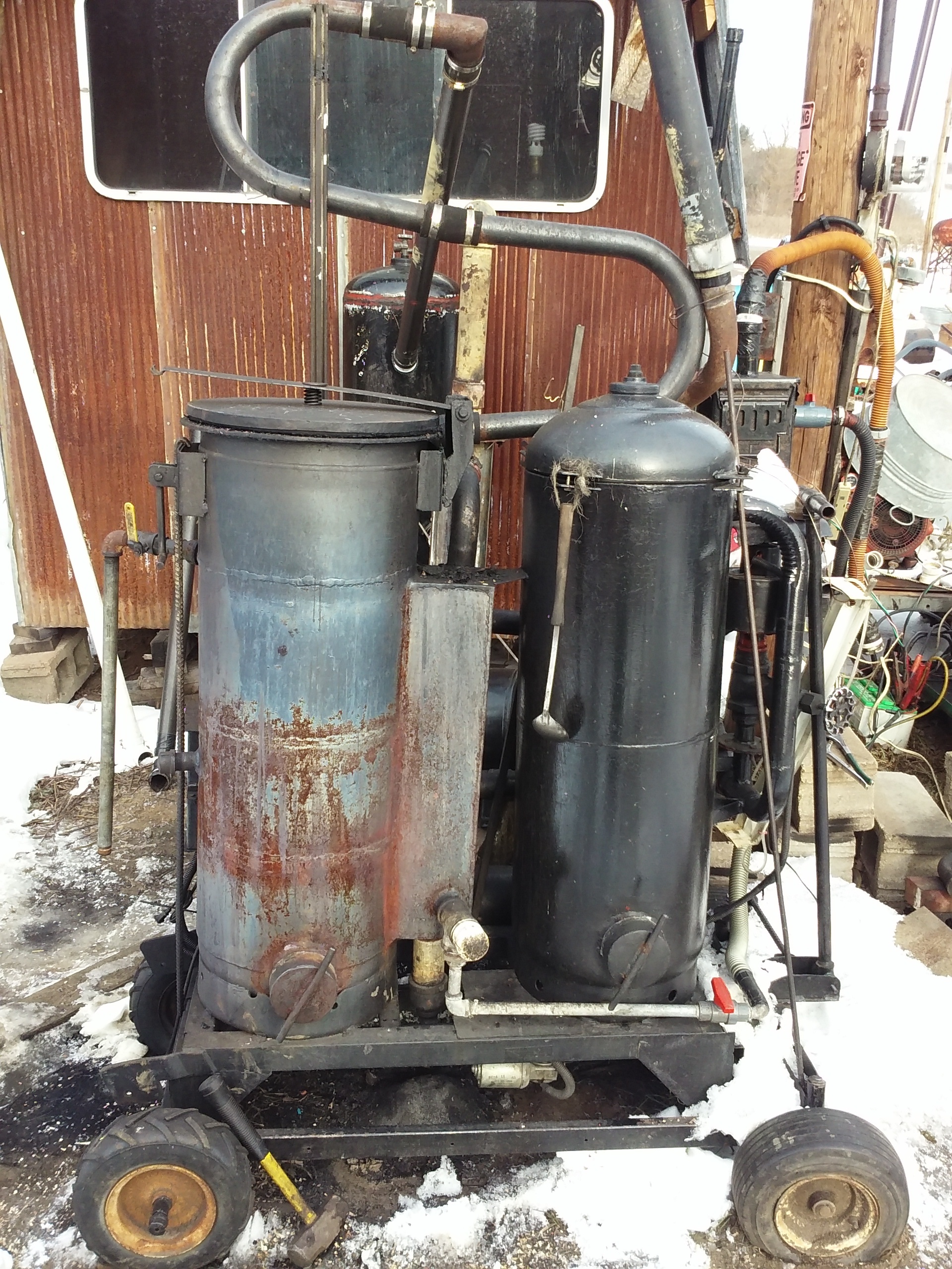

A gasifier is the way to go . I built bens gasifier 3 or 4 hours charge the batteries on cloudy days
Welcome. Nice looking machine you built. :slight_smile:

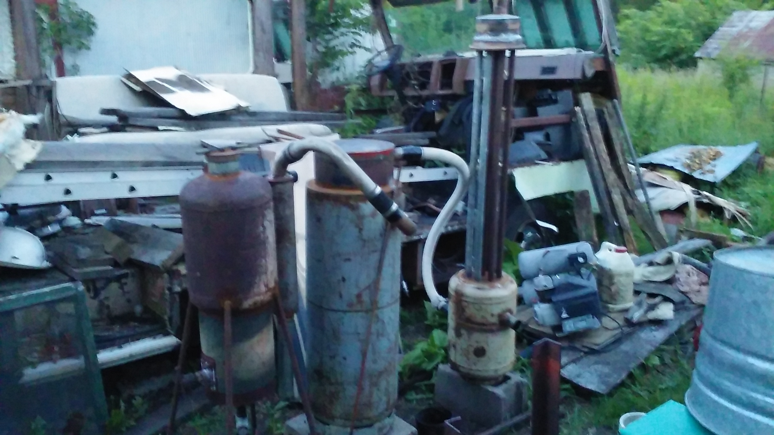

I have a small solar setup 8 or 10 batterys charging . from the junkyard runs my tv @ lights . the gasifier helps a lot.
How many watts are your solar pannels?
Are you running a generator off your gasifier? if so how many hours to charge up for the nite? One last question: are you totally off grid?

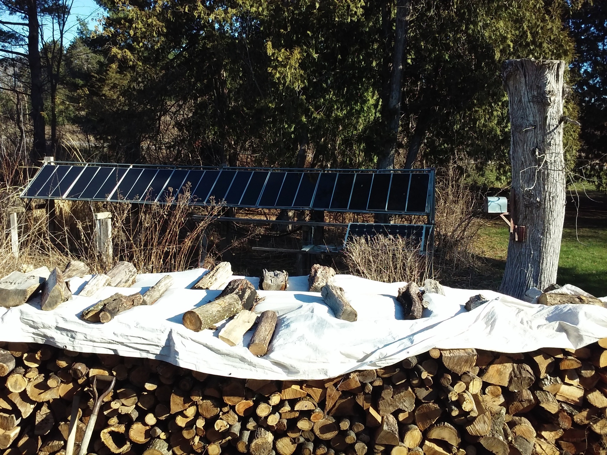

360 from harbor freight. During the summer I charge every 3 or 4 days and to pump water. Yes I’m off grid. 2 to 4 hours of charging or run my air. With my gasifier or charcoal gasifier
You would be better off buying whole panels online instead of harbor freight. They used to be the cheapest panels you could get but not anymore. You can buy monocrystaline 12 volt panels for around 1.40 a watt. Higher voltage panels get under a dollar.
