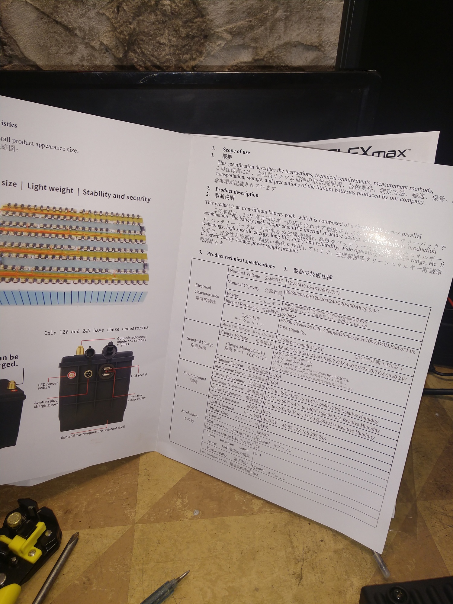

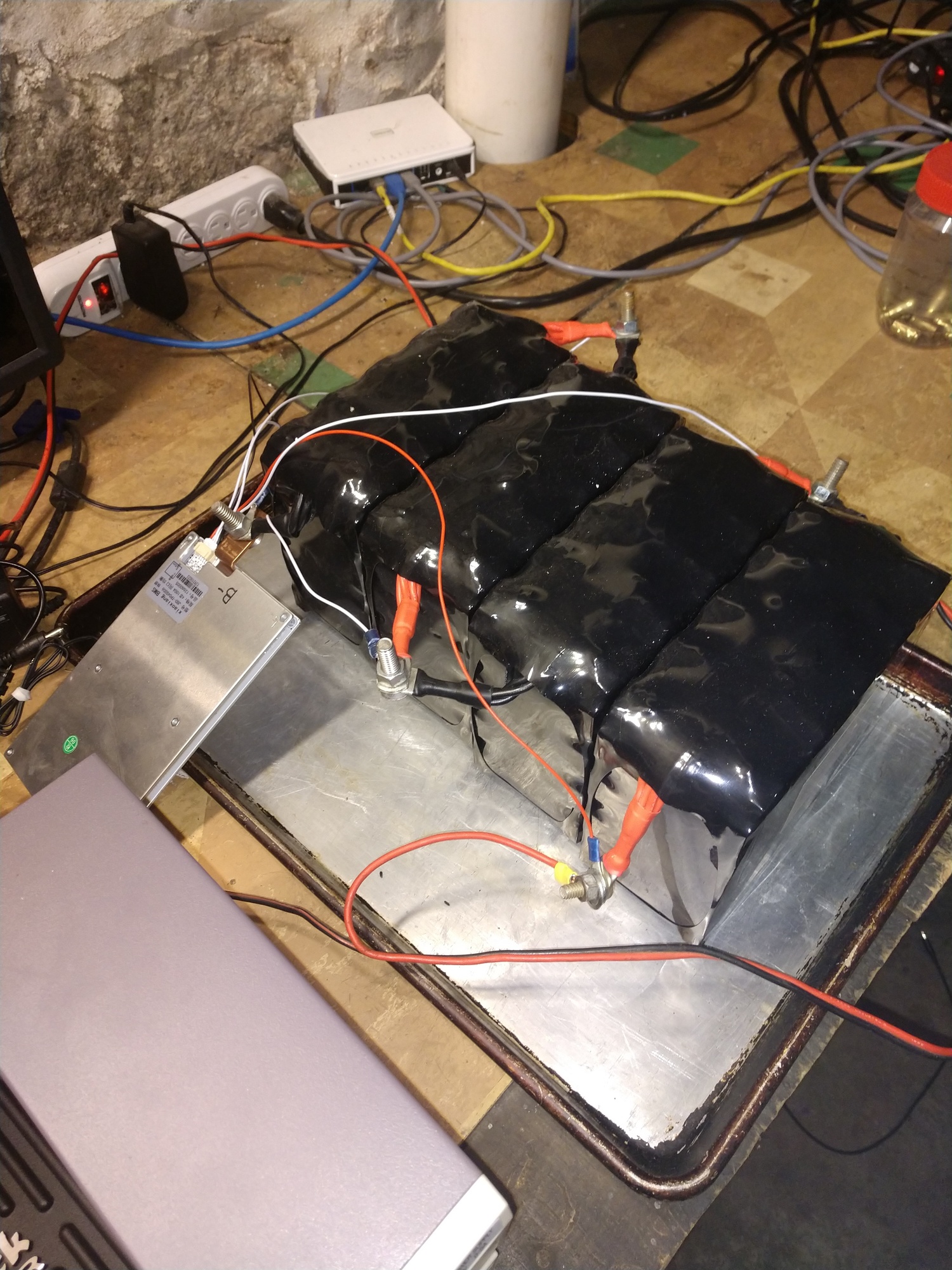

https://batteryhookup.com/products/new-12v-100ah-lifepo4-kit-w-bms-low-temp
I ordered this. It’s $50 more then a Remy group 31 AGM. It’s $100 less then the Weize prebuilt 100ah battery on Amazon.
I am interested in learning something new.
I am also becoming frightened by the phrase “currently unavailable”.
Those kits are built out if the individual cells they sell at battery hookup. I didn’t look closely at the kits but I did almost order those cells and would order them now if I was starting my peoject over. If they don’t shrink wrap those cells I would either order the tube shrink wrap that fits or buy capton tape and tape the exposed bus bars before putting those batteries in use. Other than the potential for a short on the ends in the photo it looks like a good kit. Also if you want higher voltage I would contact them directly about what your project needs. From what I can tell on their project page they will work with you and swap out the BMS in a kit like that to size things to fit your project. I have never tried but I have read stories online about them being very helpful. I think you will be happy with that purchase.
I am going into this with no expectations. I just I have to start learning the foibles of this tech now. Then I will be able to recognize good deals when they come along.

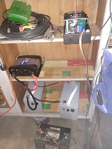

I am making some progress on these LFE or LiFePO4 batteries. We have two 12v Lisuateli 100ah batteries. Also a battery hook up kit, 12v @100ah.
I quickly discovered I don’t have a charger. I am using a radio power supply to trickle charge. I will need a series array of panels to get the Outback to charge these guys.
I need to learn about this “c” charging jargon too.
Tonight I want to sit with the batteries and watch their charging curves on the power supply. It kinda looks like lead acid, in the way it pulls the system voltage down to what ever the batteries are.
So now we take the tool batteries inside to charge, heating them up before applying the chargers. Learning curve.

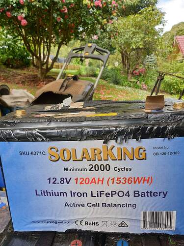

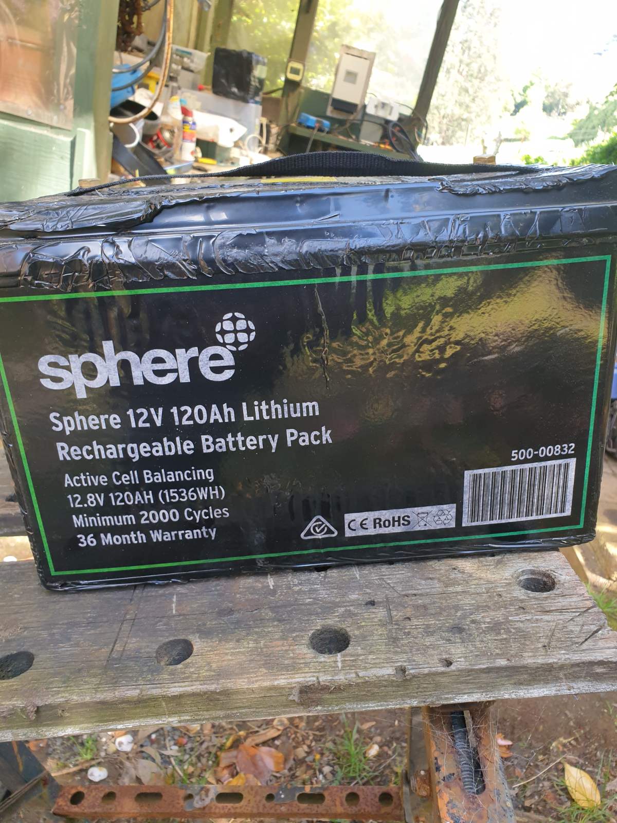

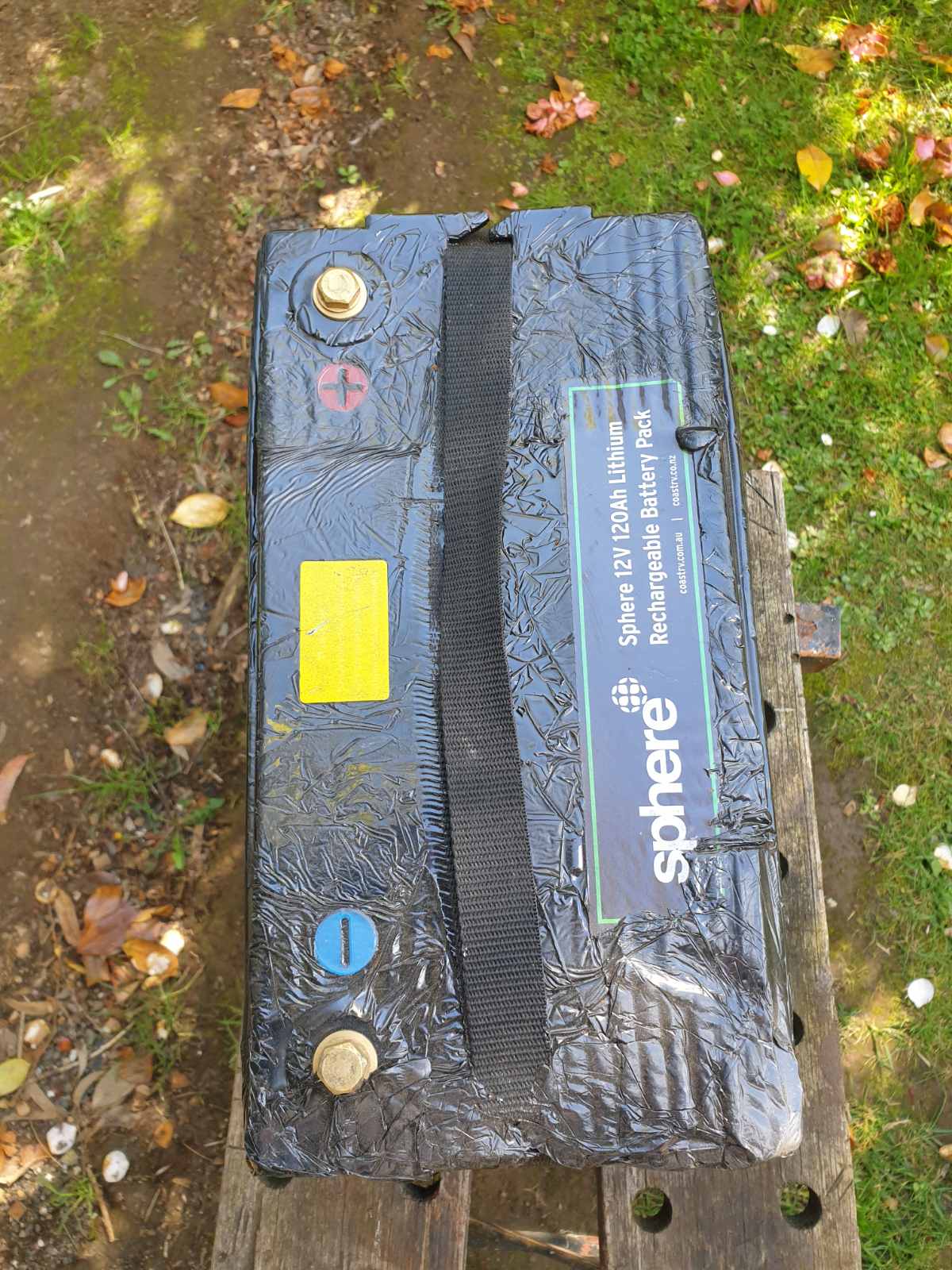

Hello Bruce , Lifepo4 batteries are great , i bought 16 used 100AH cells with 95% useable capacity still in them , cost me $1000 AU plus another $160 for the blue tooth bms , then 2 months ago a friend said he knew were there was a pallet of insurance write off batterys for $100 each , went to have a look at them and by the time i got there only 8 left so i did a deal and got them all , each battery is 120ah complete with balance board and bms built in these are brand new cells that were stuck inside a shipping container that got a little hot inside and so the cases were slightly melted in places , no damage at all to the cells inside , so i resold all the used cells and bms for what i paid for them .
These were my old cells i sold
and this is what the new batteries look like
These batteries sell for around $800–$1100 mark on the 4x4 and RV sites so i am well happy with my bargains and i can cope with slightly unsightly makings on the outside of the cases .

Dave I bought some of batteries like the ones in your photo from a battery hookup. If you take a heat gun to the top you can melt the glue holding then together and open the case. Some have screws in the corners you can get to from the bottom. But a word of caution those contain pouch cells the ones I got for salvage where all different sizes so I couldn’t mix and match the cells and they where high to damaged swollen cells every though the outside cases looked perfectly fine.
But here is where the real problem comes in. Those have very simple BMS boards really they are just over charge protection and very limited at that the resistors are tinny circuit board resistors I am sure the ones I had where damaged by a dirt bike or ATV charging system providing more power than the circuit board could dissipate when the cells got out of ballance because there is no way to ballance charge short of letting it burn off energy at the cells that are at capacity when the weak cells catch up.
So I would definitely limit the charge rate on those cells. But more importantly the OEM specs I read on almost all of those pre packaged 12 volt batteries said do not connect them in serries unless they have a communications cable to link the BMS. I would definitely get as much OEM informant as I could before connecting and charging those batteries.

Hi All , according to what the sphere web site says these battery’s have prismatic cells inside of them , 2 of the 8 battery’s were SolarKing make and looking on a site that has these for sale at a cheaper price say that they have a advanced BMS and balancer and cylindrical cells
