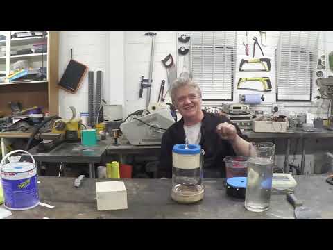

Robert murray-smith’s paper battery is very similar, except these guys are claiming it is rechargeable, and you can dispose of them in safely. I am not convinced their claims aren’t extremely exaggerated. They are looking for 5M in investor funding. I don’t think they are looking to tap into the Ukraine funding, I think they just want to become millionaires.

Robert Murphy Smith claimed his paper battery was rechargeable which is why he was trying to build a pack for a EV that he never finished IIRC. He was in talks for mass production but claimed he didn’t want the license process IIRC.
I think from all his stuff i studied if you could get the bromine that battery he showed was a great DIY battery. I think you could literally make them in glass jars like canning jars and build a decent battery. I started looking into that bit iirc the bromine was either too hard to get or too expensive on small scale conpared to LFP mass production.

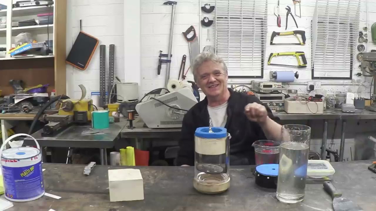

Robert Murray Smith had bromine as a liquid battery much like lead acid batteries. It wasn’t a flow battery. IIRC it is a very old chemistry that GM used for an electric vehicle back in the 70s during the first energy crisis but i could be wrong on when they prototyped a bromine battery powered car.
There is one of his videos about a large scale zinc bromine battery including the patterns he based it on.

It is 225g/mole for zinc bromide. or his 1.5l of 2.5 molar solution has 843g in it.
These guys have it for $10/kg.
https://www.alibaba.com/product-detail/Zinc-Bromide-Znbr2-zinc-bromide-for_1600724738257.html
Then what SorbiForce is doing is using a paper separator instead of the ceramic one that Murray-Smith is using. And they are using electrically conductive carbon for the anode and cathode. and even in the video, Smith was saying, you can get all fancy with the design of the separator, and I think that is what SorbiForce is saying they did, and that is their technology. Not the zinc bromide, as it works with other chemistries as well. They said, they could just use water, and they probably could use iron. The zinc bromide just had better performance. However, it reacts fairly slow.

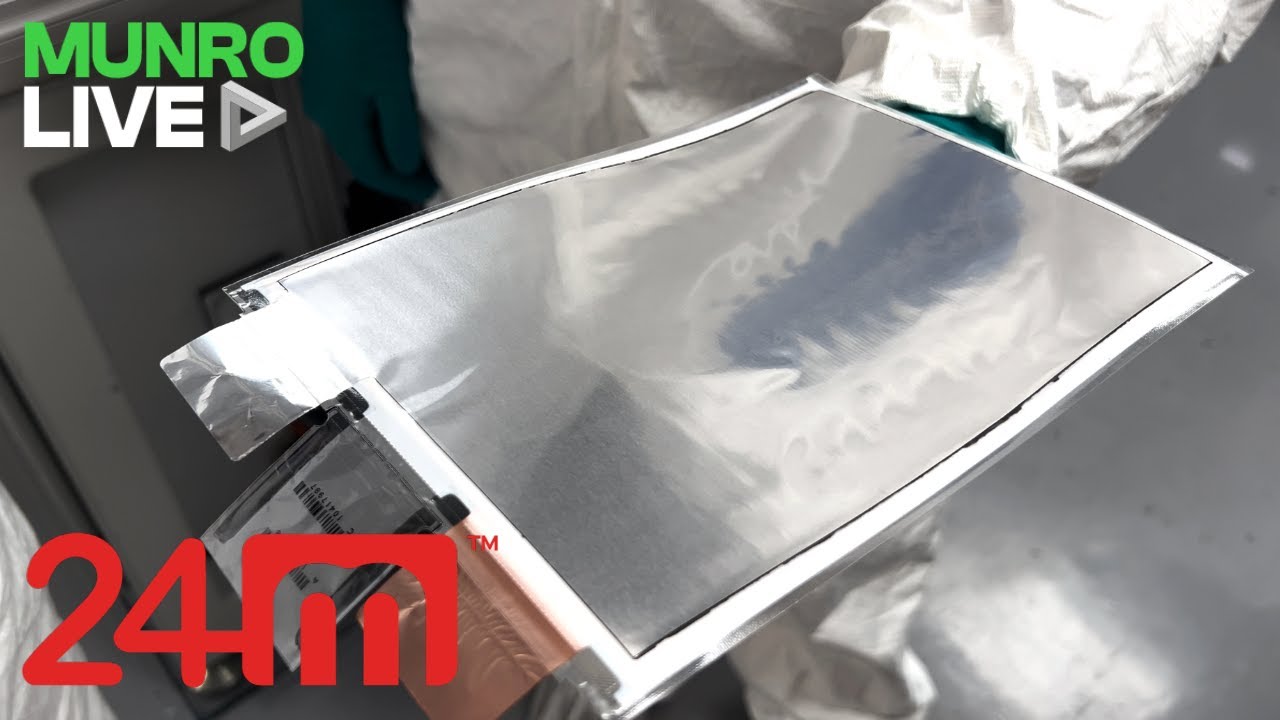

Since we haven’t talked about it, 24M has a lithium battery that has a super high density 500wh/kg, is good down to -20C (-4F), and has superfast recharge rate ie 4 minutes from 15% to 80% capacity. It uses a different electrolyte and separator technology to achieve this. If true, it potentially cuts the size/weight of a battery pack almost in half.
Not as much concern about cold weather, or range anxiety (provided there are charging stations)… not sure about off-grid applications or cost of the batteries.
24M doesn’t make batteries, just components. The link says Eternalyte is wonderful. No clue what it is. Time will tell.
Time will tell. They say the electrolyte is a proprietary blend of stuff and I did read something about the separator they are using.
This is Sandy Monro’s video on it. They go through all the steps and talk about step improvements. It goes kind of slow.
