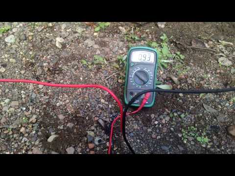

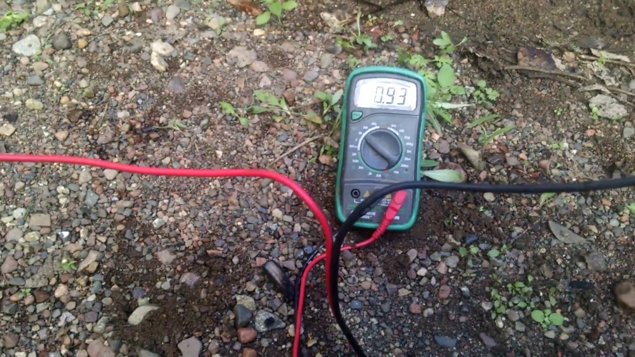

Has anyone looked into making an earth battery that is usable?
In the late 1800’s and early 1900’s the telegraph companies lines were powered by earth batteries along long stretches of lines in remote areas across the USA.
People have found their remaining parts in the ground along old telegraph routes.
People have built them in recent years. Look on you tube.
It works sort of. It is a dielectric current so it is slow corrosion. You can get a small current off your plumbing pipes if they are metal to the ground.
Yes my understanding is that you don’t get much more then enough to power a few led lights. I haven’t tried it but I couldn’t see a way to get a usable amount of current.
As to plumbing pipes I would avoid it for fear of increasing the speed at which they fail.
