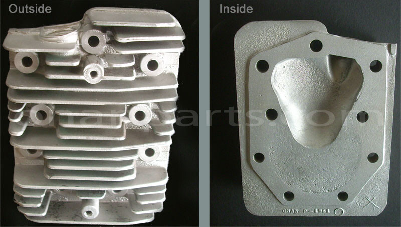

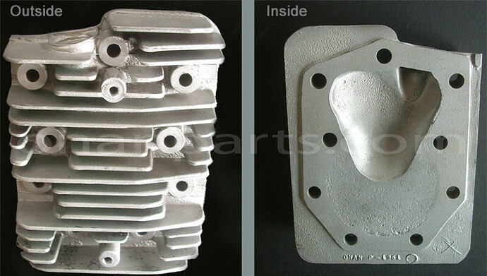

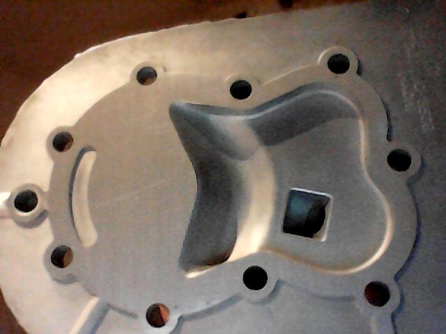

Its going to require surgery to the tin work but you can fit a set of BG heads to the BF engine. Mill them flat so the head has no pocket over the combustion chamber ( About 0.060 milled off ) Use the same plug as the BGE ( not sure what that is off the top of my head ).

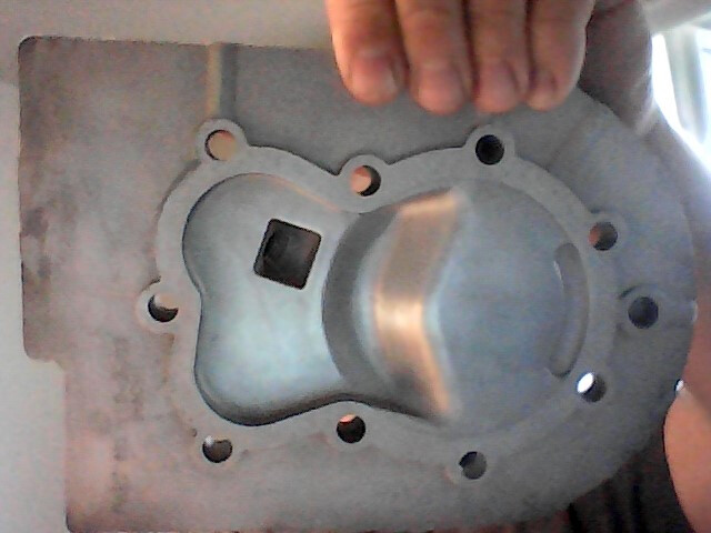

A CCKA or B or really any of the high compression heads for the 3600 rpm CK engines are also a fit for the BF BUT also will require some tin work surgery.
This little boost in compression will help with wood gas, you should bump the timing too.
My personal feeling is the BGE head is better because they are much cheaper and easier to find and its a newer design with a more central located plug and the camel hump for better gas mixing. Beleive it or not inspite of the different engines and decades they were made these all bolt on any 9 bolt cylinder head.
Stock BGE head
Milled BGE head
The high compression CCKA head

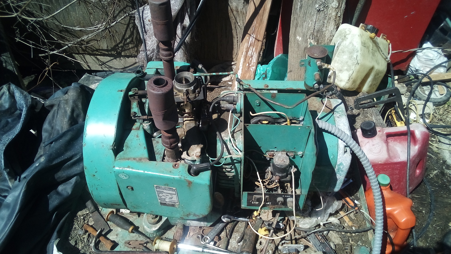

this generator didnt get ran hard i cleaned the valves set lash and put gaskets on the intake i kind of live off grid and fuel cost is something that is difficult my line went down in iceamegeddon they want to much to fix it so i need this to just run basic things like no more than a washing machine and well pump ive never managed to load it more than a little off idle@60hrtz its runs the 3/4 hp shallow well pump without much of a grunt im semi new to wood gas/ simple fire i could distill things to a liquid fuel even turpentine since i have many pines that have fallen this is to get me though until i can build a water wheel and experiment with wood as fuel many ideas to explore i have watched the mr tesolonian build basic stuff right now i have to magyver something together with a old well pressure tank an old style galvanised pressure tank a few pieaces of pipe and misc around here im welding with an oxy torch the big tank i have is i think big enough to cool the gas down the old pressure tank i welded a pipe and cap to load it in the idea is to make charcoal then burn the charcoal and cool it down with my other parts i was thinking if i angled the 1/2 pipe and resticted the intake enough to get it to draw the gas i thought reduceing the intake down to far would not let it run and cause a strong vacuum on the 1/2 line in some ways that might be good it might be possible to go to 3/4 or 1 with what i have laying around but i wanted to ask i will get pictures of what im working with
I did it by hand in a vice by draw filing and finished on a glass plate with a dial indicator to check for depth of cut and squareness.
I recommend you have a machinist mill to be sure two are identical…

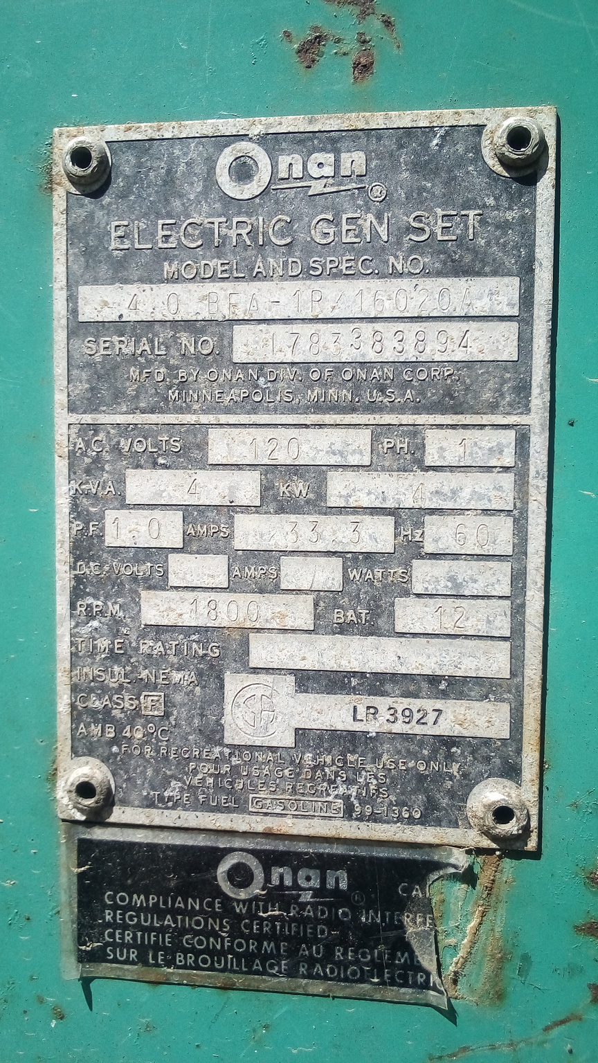

Please look for the model an spec number on the unit and post it. I will find you the electrical prints for it and a service manual.
This is a 4 stroke Johnson "Chore horse " Canadian slant on the Maytag engine that many folks without hydro used when they wanted to wash cloths ( made them right up to 1970 ). When I was a kid we still had an Inglis washer with a Chore Horse doing the wash at the cottage…

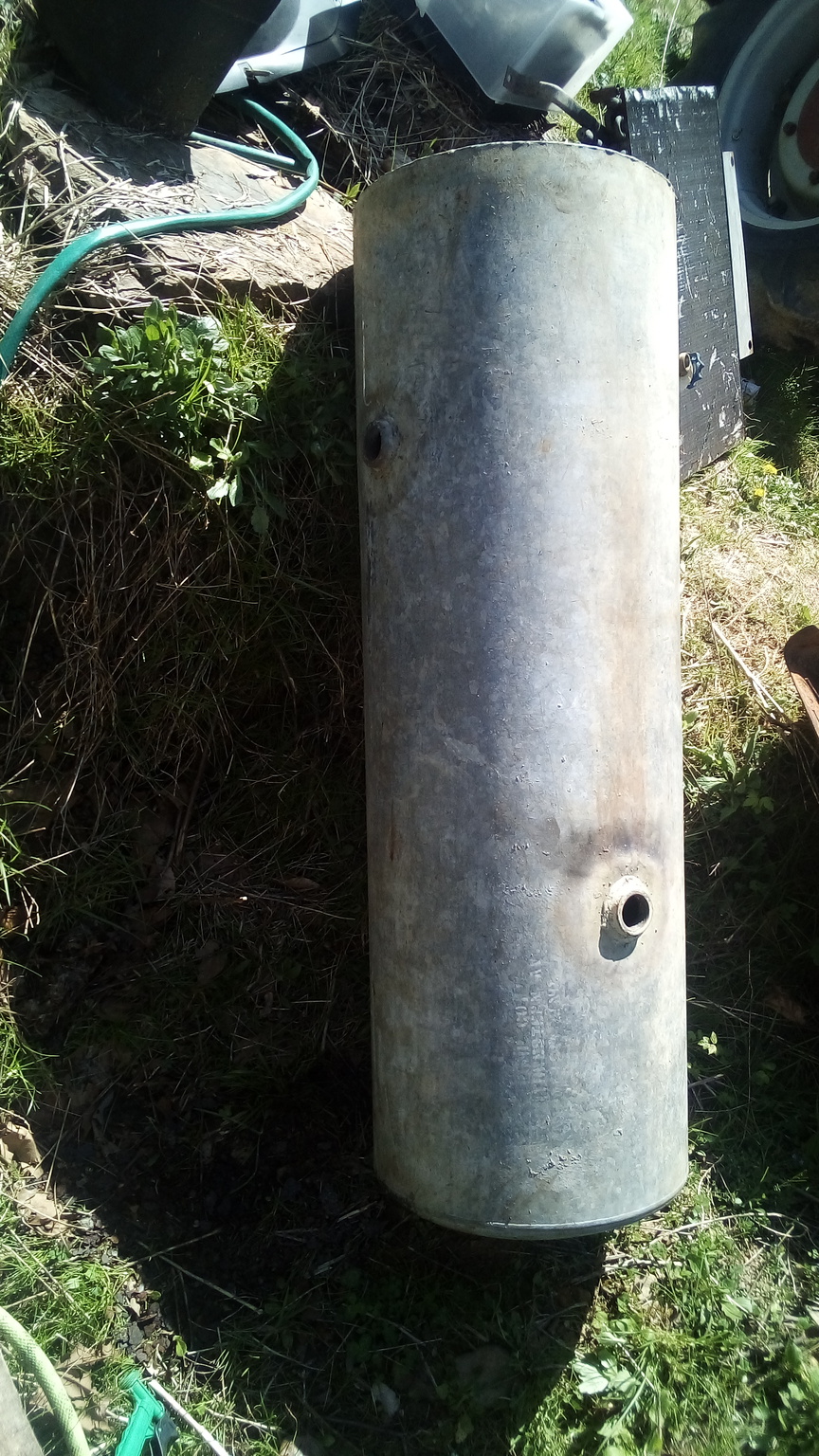

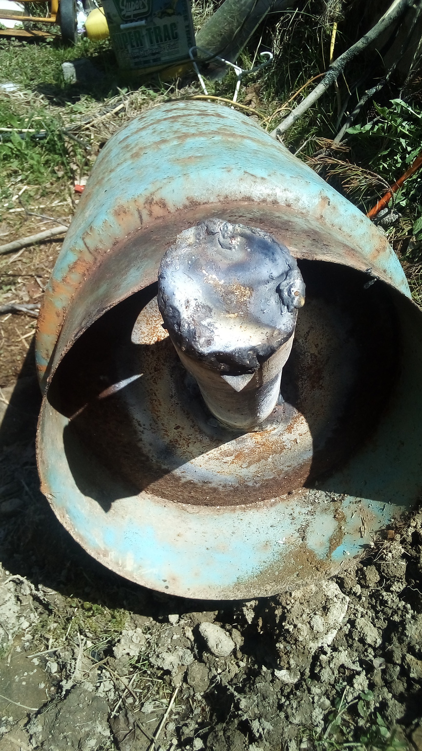

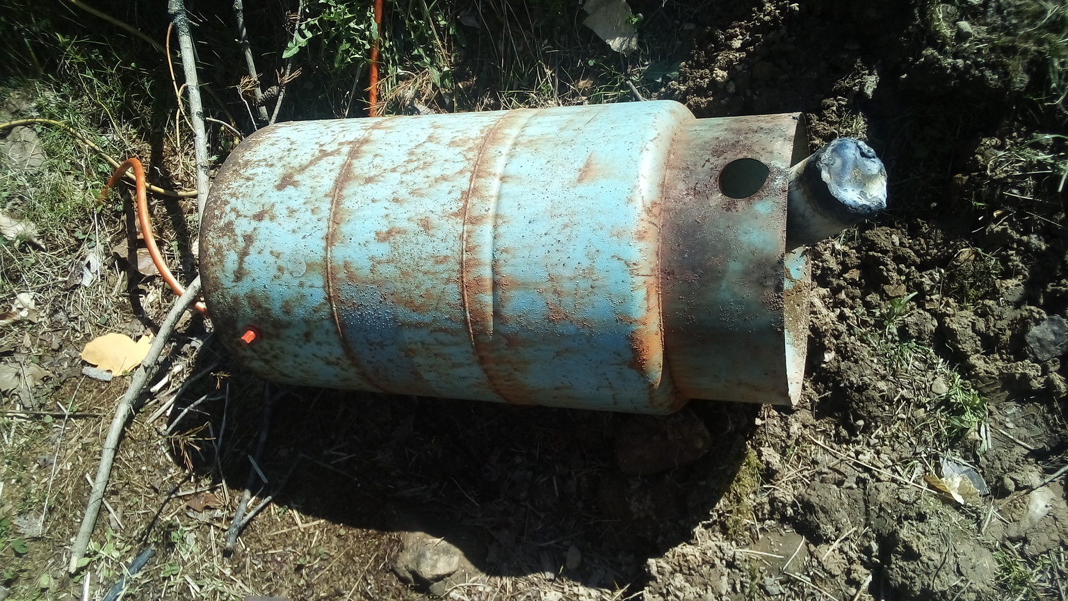

yes i was/am working to off grid i would love to get these old type of machinery it is just me and with id issues driving isnt possible but im in the mountains of kentucky heres some pics of what i have so far please excuse the welds im oxy/torch welding
opening for loading fuel into
this is the tank that would have fuel loaded and fire built underneath it that would hold the charcoal or plastic pine to either be distilled or to burn/ make charcoal in

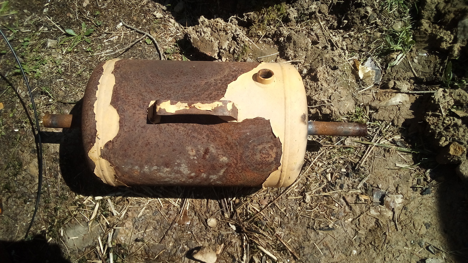

this is the first tank after the firebox/fuel chamber
the idea is the gas would enter the lower portion that would help cool and can condense and drop out any nasty stuff
going from mr tesolonians setup
im assuming the lighter gas would go to the top of the tank from the charcoal tank it is 1 inch pipe

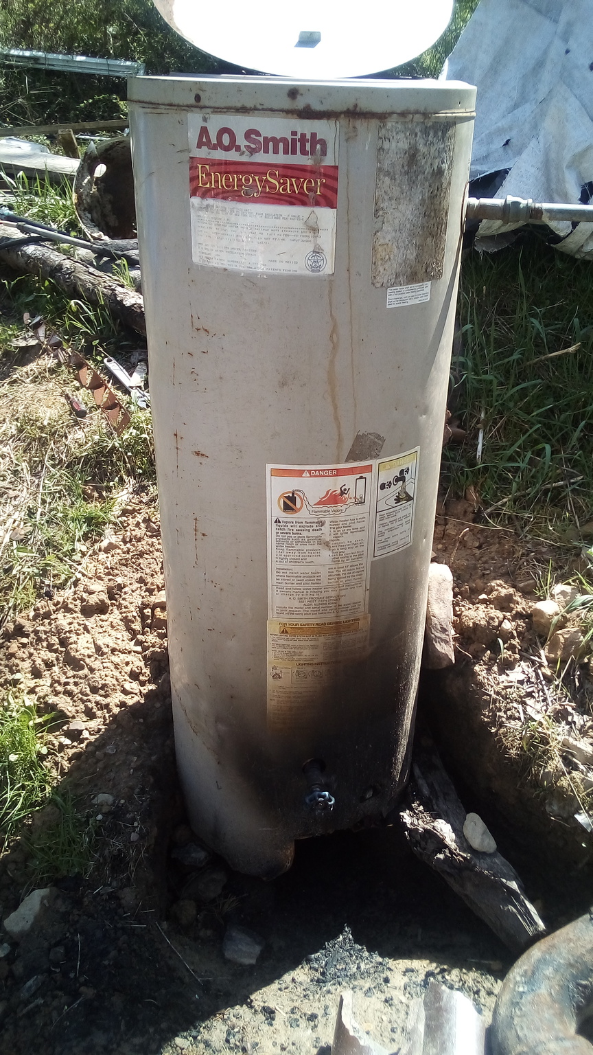

this is how im heating water
I am going to have to get my best glasses out to read that Onan name plate…
Just because it says its only 120 volt does not mean it is. It just happens to be more complicated to do and it was only done on items intended to export to 50hz 240 volt countries.

You really want to look around for a gas or oil fired hot water tank, they will burn significantly less fuel wood than what you are doing, trust me…
I will post more detail on Generator and look at the gen end connections when I have some time be patient…
Wally
inside the cover of the box it has a schematic but i do have the m1234 wires im not heating hot water with it just using it to run the pump and washing machine on cold water the washing machine is in a mobile home im in a 25x30 cabin the mobile home my mother lived in then moved back to ohio after my father passed the only reason to convert it to 220 would be to use a stick welder on otherwise 110 works fine at night i run a 2 cycle generator but its not big enough to run the well pump and i think a washer run time would be over 30 min i would love to have a ringer washer but i have to work with what i have it would be nice to have a partner that wanted to live a rural off grid lifestyle i only need to run the onan for a brief time but even if i run it on charcoal the power wont be wasted the way it runs now it would slurp 5 gallons in no time i heat my water by an old gas water heater
