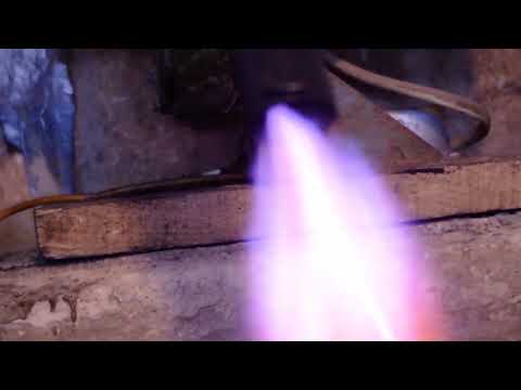

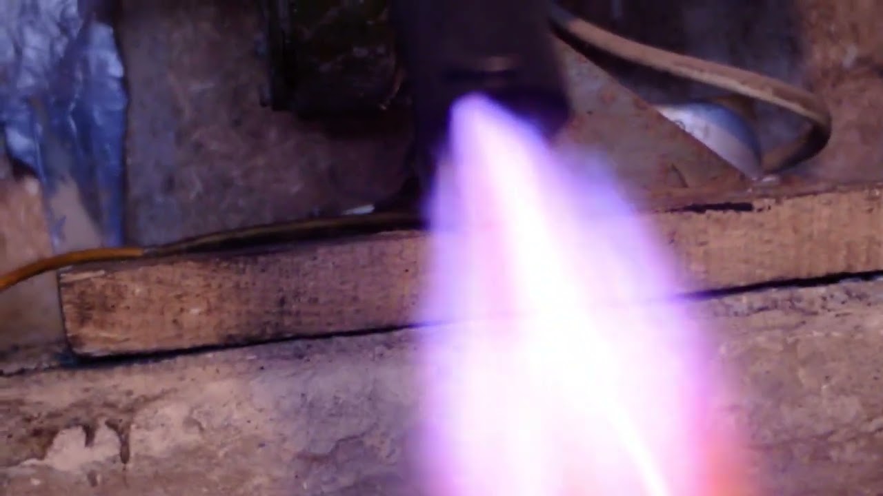

gasifier now is back in one piece - and it got a new blower, the previous one was pretty weak and it took a lot of time to warm the gasifier up.
it is MUCH faster with this one
