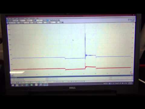

[More on how I will evaluate wood gas engine combustion, in part. ][1]
New engine test stand and update on my gasifier.
