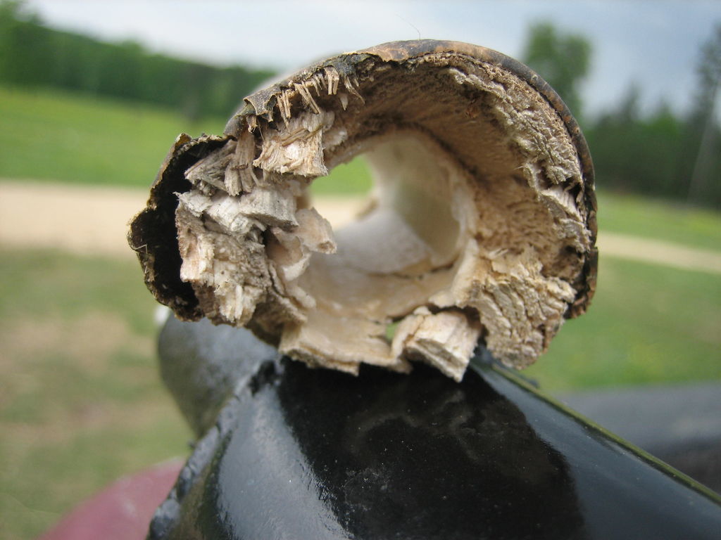

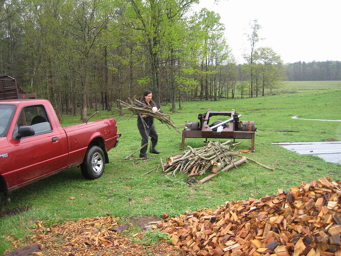

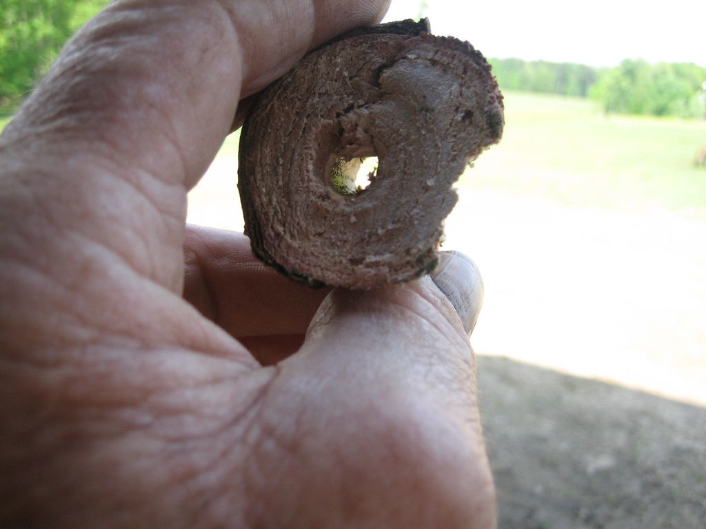

Has anyone heard of paulownia trees?
I received some this morning that I have chucked up and will dry and test in the trucks.
I will be sharing my thoughts on the wood as motor fuel at the American Paulownia Association conference next month.

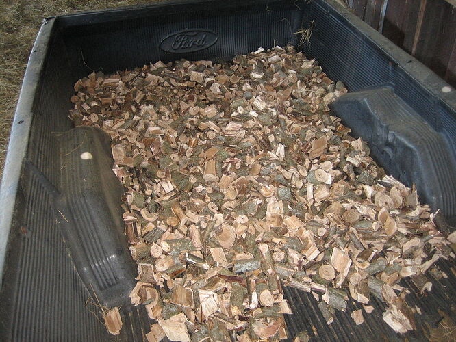

I drove with PAULOWNIA wood today.
As for power it seems to do as good as pine, oak and hickory. It is much lighter than the wood I have been using. The small plastic bags that I keep wood in weighs 14-15 pounds with oak, 11-12 pounds with pine. The paulownia weighed about 9 pounds per sack.
This wood dries faster than any I have used.

The paulownia was very easy to chunk and dried faster than any I have used.
