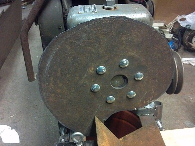

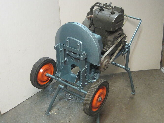

I have been working off and on building a portable wood chunker mainly for limbs and branches up to 3 inches diameter that I can take along easily to where the fallen material is located. This started out as a junk air compressor that I used the tank for my burn tube housing. The mounting plate, handle and wheels now become the frame for the 2 cylinder military surplus engine and the 90 degree reduction gearbox that the blade is mounted to. The lift off removable blade guard was salvaged off a defunct chop saw. Folding legs bring it up to standing working height so a five gallon pail can be slid under to catch the cut wood chunks. After a fuel tank is installed and a belt guard, it should be ready to fire up and try out. The engine runs at 3600 RPM and is reduced 60 to 1 through the belt and gears which puts the blade speed at 60 RPM or one cut per second. The blade profile increases diameter 1-1/2 inches for the first 1/4 revolution, then 1-1/2 inches for the next 1/2 revolution and another 1 inch for the final 1/4 revolution. The anvil plate next to the blade is adjustable for clearance and for possible future blade thickness changes at replacement. Hopefully I will get it finished next week and post some video of it running and chunking!

Is there a stop for the chunk length?
Wes, it depends what angle you feed it. The gearbox housing acts as a stop at about 3 inches if it is fed more level and if it is fed downward 20 degrees it could shove in quite a way but you have to be quick because the first part of the revolution of the blade is aggressive.

After you use it a while and get a feel for it you may want to experiment with some weight ( flywheel ) on the incoming pulley. The extra momentum will make the chunking much easier on the motor and belt.
Don, I think you’re one of the first to think of chunking while on the road, kind of a Swiss Army Knife that can’t fit in a pocket!

Don , thats a good looking chunker man , you taking orders? lol
Couldn’t you just put a reducer on it and maybe add a fly wheel. Other than that I wouldn’t change a thing the fuel its makes would run perfect in our machines. Nice job!!

I also want to make a chunker. What I was thinking about for a flywheel using a dumb bell weight. I’m sure I can find one at a thrift store near by. I would like to run it off of hydraulics. I was hoping to keep it small like yours Don.
Nice work guys. Both of them look really good. Don you might need a centrifugal clutch to keep it from stalling out. A flywheel could be mounted on a jackshaft.
