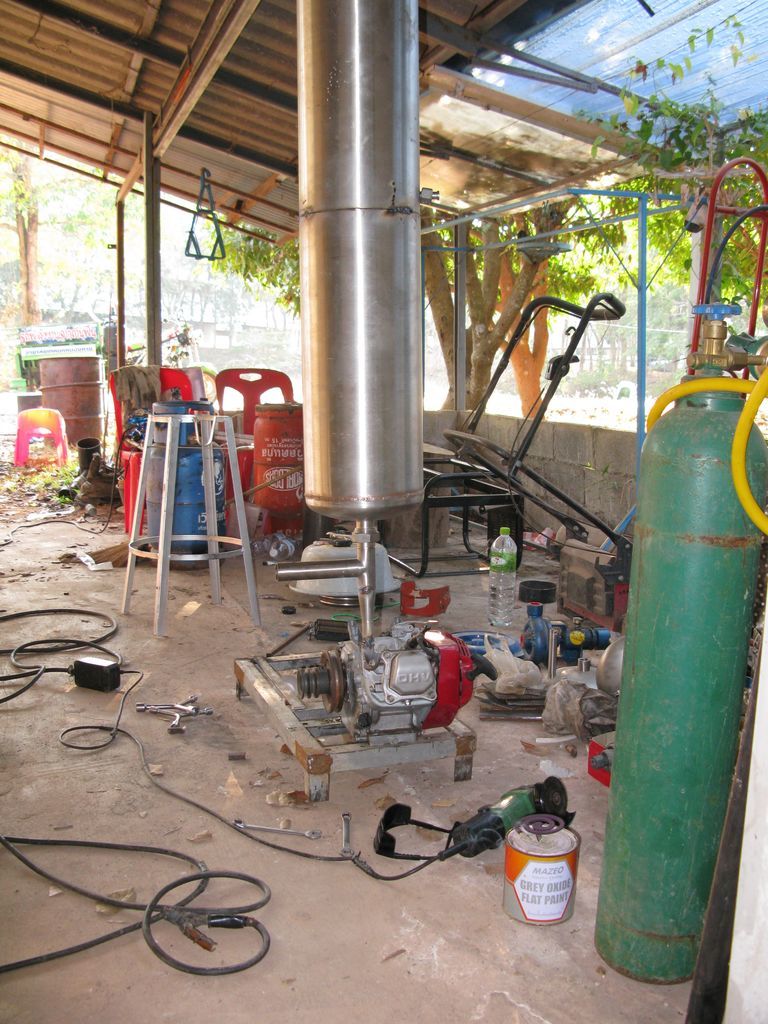

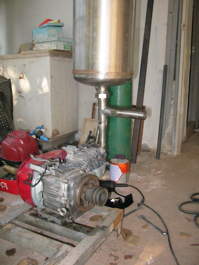

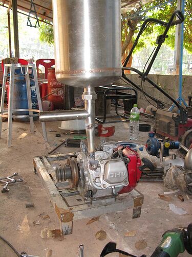

This is old stuff and now i will try to superheat the Exhaust gasses with a little help from a HHO burner and i will see what it becomes
If a engine can run on the gas, great
This time i spare the numbers, just put the charcoal retort on the exhaust and blow the heat thru the charcoal :-p
After that, i will figure out what went wrong

anyhow, here we are working with charcoal gasifiers and make the cranckshaft turning
can’t wait to see results
using glowing charcoal as a catalyzer
how accounts you overheat the reactor with this setup?
The normal exhaust gas temperature is between 600°C and 900°C, i will increase the heat with an HHO torch up to 1300°C and blow that into the charcoal.
Just need to figure out the perfect place to inject the HHO
Looking for some ceramic tubes to do so
for which reason the hopper so high?
To keep the gas temperature low at exit ( 40°C )
The descending feedstock will absorb the temperature from ascending gas
I have to keep a layer of charcoal, about 60-70 cm above the nozzle.
