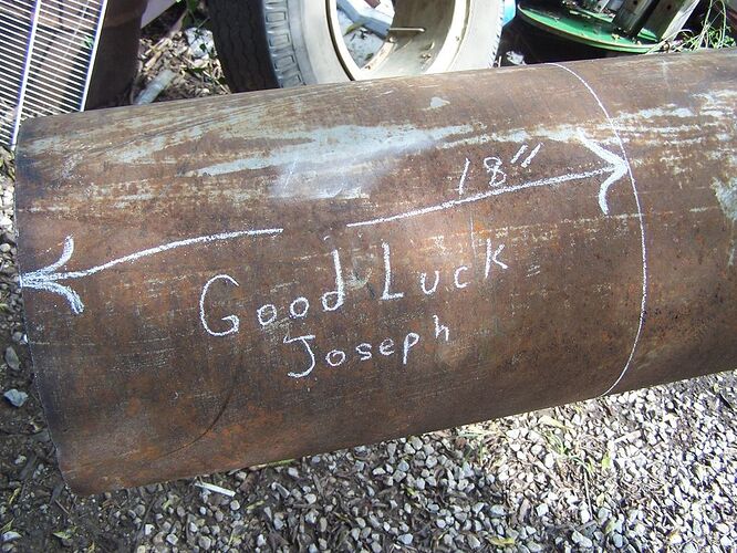

Joseph…I will cut you a 12 inch I.D. fire tube to what length you want. No charge… just what ever it cost to ship it to you if your interested. Same pipe I made mine from. Came from the refinery where I work so it is a good quality pipe. I believe it is 5/16 thick walled, could be 1/4 I can’t remember. Will check it and see for sure. I’ve got close to 5,000 miles on mine and looks like the day it was put in service. Let me know. My zip is 67337 if you want to check on shipping.

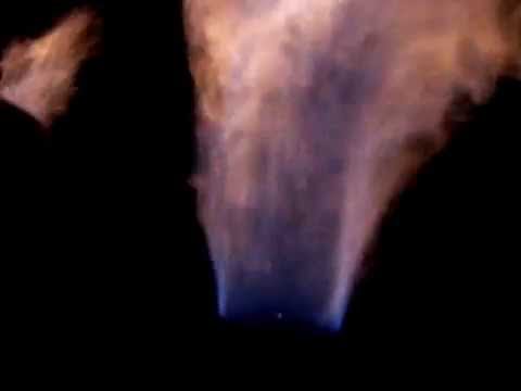

Joseph…I got called back out to work last night after I got home. Was just getting ready to get the pipe in the shop when they called. Had to work until midnight. Will try to get it cut tonight, I’m off the on call list now. Made a video last when I got home from work of the gas flaring off with the gasifier good and hot. Check it out if you want.

Yes, we have invented a new color: “burning woodgas” and that was a classic example.
Hello Gary.
Thanks for the video . Yes you look pretty gassy there . Great example of working gas .
Ha! Ha! Just caught your video down at the Library checking-in GaryL.
So I take it you are not willing to abandon your evil engine corrupting ways just yet and join the Cult of The Blue Flare Starers, eh? They have a new Preacher now you know. A real pulpit thumper. You could spend years humbled, becoming pure and blue enough.

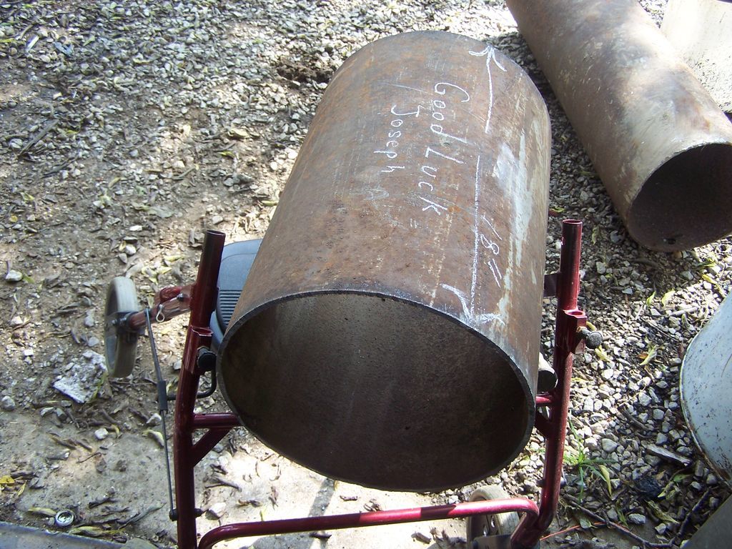

Joseph…got your tube cut this morning. I will be sending you an E-mail this evening so we can work out shipping details..
