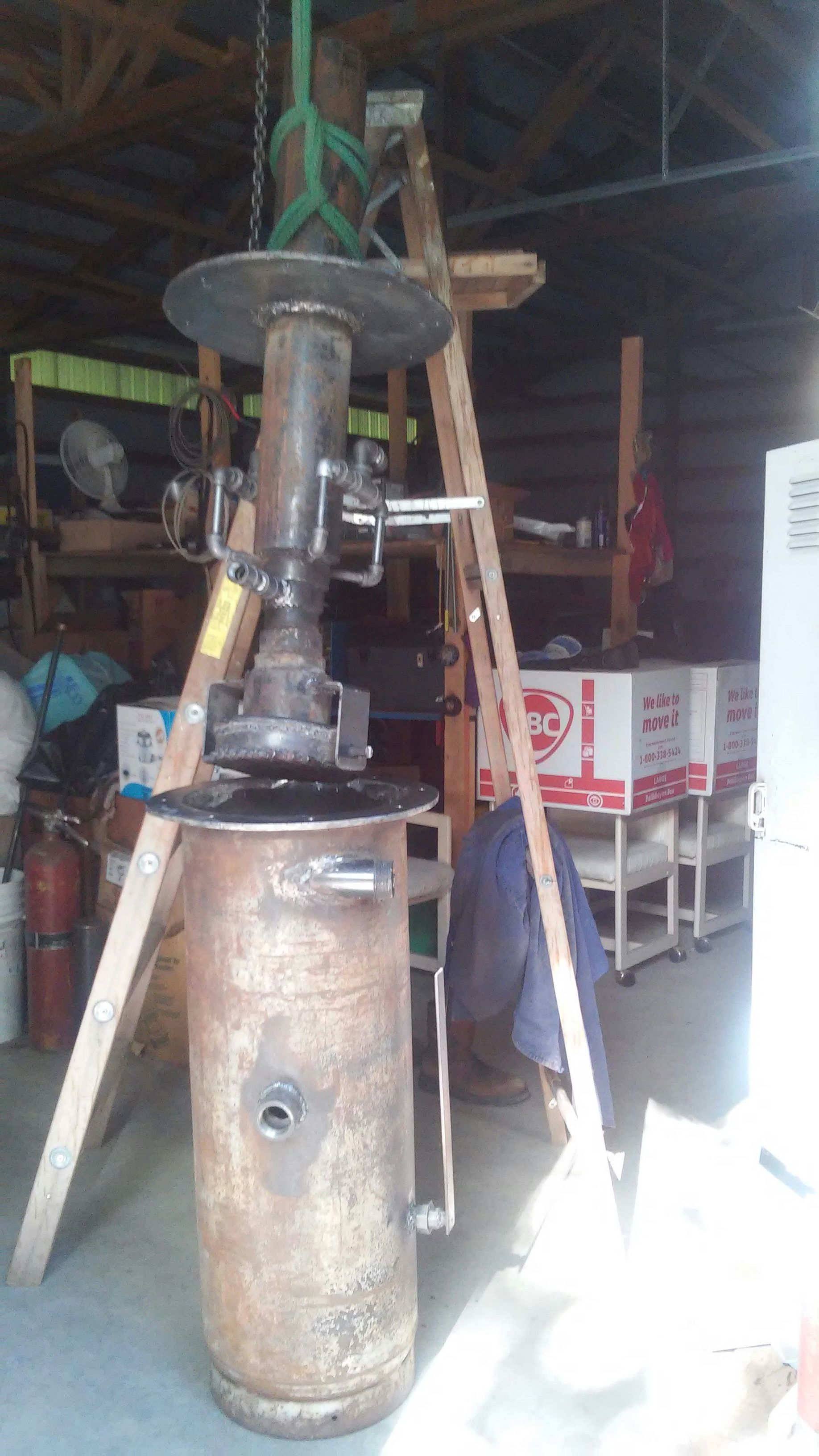

Now I want to see video of you running the Studebaker on woodgas. I see it’s all hooked up in the photo…

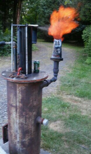

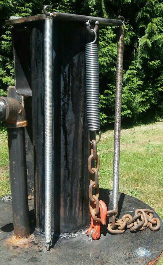

I’m still the experimental stage. I started with 2 screen door springs, but had to add a third stronger spring that I can adjust the tension on to maintain a good seal on the gasket.
First make sure you have a gasket that is sealable. Don’t over do the spring tension trying to seal a lid that is not a good sealable surface for what ever reason.
Russell what is the diameter of the tube your sealing. It just looks like a lot of spring tension for not very many square inches of lid surface.
Good stuff : ) Amazing numbers for wood gas.
RUSSEL that gasifier on the right looks like it would run a motor quite some time,and the spring looks more like a garodge hinge up door spring, likely just the camera distance alusion.NICE BUILD

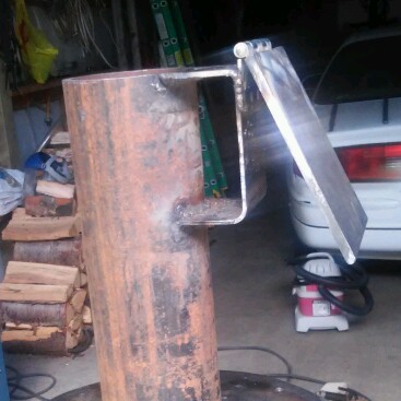

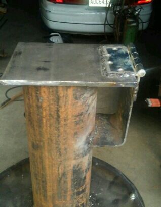

I have a 5" sch 80 pipe with a 3/8" plate hinged for a lid. Having trouble getting a good seal with a rtv and fiberglass mat gasket. You can see it leaking in the pic I took today. I’m using a small shop vac as a blower for it at this point. Maybe I should weld a flange on top of the pipe for a larger gasket surface ?
Hi Russell
Are you pushing on the inlet or pulling through the system? It might seal under vacuum easy, under pressure will be a lot different tension needed. What are you going to use the gasifier for?
I’m blowing into it with a shop vac for test purposes, I expect you are right about that making it harder to seal. I only built this to learn about gasification and see if it would work. I will be returning to my retirement home in the Philippines soon and would like to have a gasifier in my backyard for outdoor cooking gas, copper coils to a hot water tank, and to run a small generator durring power outages. I think I may wind up going with a charcoal gasifier over there, as charcoal is cheap and easy to get. It’s all just hobby work for me really, to keep busy and it’s very fun and interesting.
Not sure what too say on the seal area, It may be as Marvin W was saying,i am welding a car rim flange on my hopper,will need some strips of metal added too glue the 5/8" glass rope seal sucurely in place,havent tryed it yet,changeing motor in my truck,moveing it away from fire wall same time.Happy Retirement.
