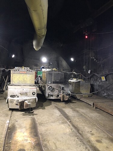

Last summer I was sent to this level and service these battery electrics because the company ( that shall remain anonymous ) did not have properly trained people to care for these old girls.
I want you to look at the cables and bunks on the sides.
How this is supposed to work is once the tram crew sees they have used their battery to about 50% of its rating or at the end of the shift they are supposed to lift the pack off and swap in a fresh one for the next shift…
Batteries are to be inspected and watered monthly.
The chargers are to run a complete charge cycle on on each pack to carefully bring them up to a full charge.
Monthly inspection is watering cleaning check for damage or wear ( controls on trains too )
Brush replacement if needed and reports and records kept to track costs and watch for issues.
When I got there this had completely gone to hell.
Dead trains sitting in the middle of the track with no power..
Batteries that were sulphated or worse dry or frighteningly so neglected they smoked when you tried to charge them
Trains with electrical issues that had caused fires ( and the ministry asking for a report on the fires and what was to be done to prevent this ).
I did not solve these issues but I did help a little to get them back on target.
My point is you have to keep records and logs and watch for trends that tell you you have a problem.
You need to do monthly service.
And you need to do daily care and up keep.
Battery systems need constant care and attention or they will fail.
They quiet simplicity will lull you into a false sense of all is well until its not, and that can cost a lot money and cause fires.
