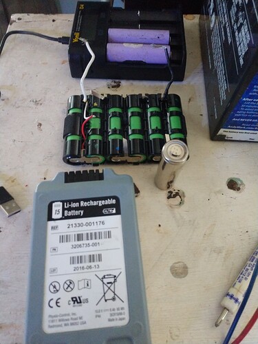

Conclusion? I would determine how long Li-ion tool batteries are lasting in your area. If they survive the heat, then start collecting them and buy a battery management system and start building banks. I am pleased with their performance here in the cold. I see the price for a 100ah LiFePO4 battery is only slightly more then a 100ah lead acid AGM battery.
Right now we are trialing all three, Li-ion, AGM, and LiFePO4.
You may not like panels, but you sure don’t have to listen to them.
This is a picture of Li-ion cells 18650 (18mmX65mm) I am salvaging.
