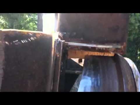

Randy Matthewson's wood chunker
my ajustable 1 to 4 inch long chunks out of 2x4-6 bunks self feeding on 6.5 gas motor youtube

What is the reduction, and what is that reduction unit off of?

thanks for the kind words the gearbox is out of a old sawmill 1960s vintage infeed chain you can find them at action. it a 3 hp 3ph motor on it . i did some work on it to mount a 6.5 gas motor belt driven to gearbox . motor has 4 in pully gearbox has 6 in 1.5 that brings the motor from 3600 to 2400 the gearbox i think is about 30 to 1 that make it 60 to 70 rpm i started slower but it didnt work the motor and still is no problem i run mostly dougfir it work better if dry hope this helps thank for the good comment

The gear box looks like a Sumitomo.
Cycloidal drive

Thanks Randy; If it is really hard to come by, do not worry about it.I really like your machine and have found several for sale for around $700.00-800.00. Just debating on getting one but would feel better if it would cut oak as easily. Have plenty of pine here in Florida, but very sappy.I could try kiln dried pine scraps to see how gasser runs. Thanks for replying. Dan
