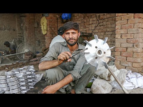

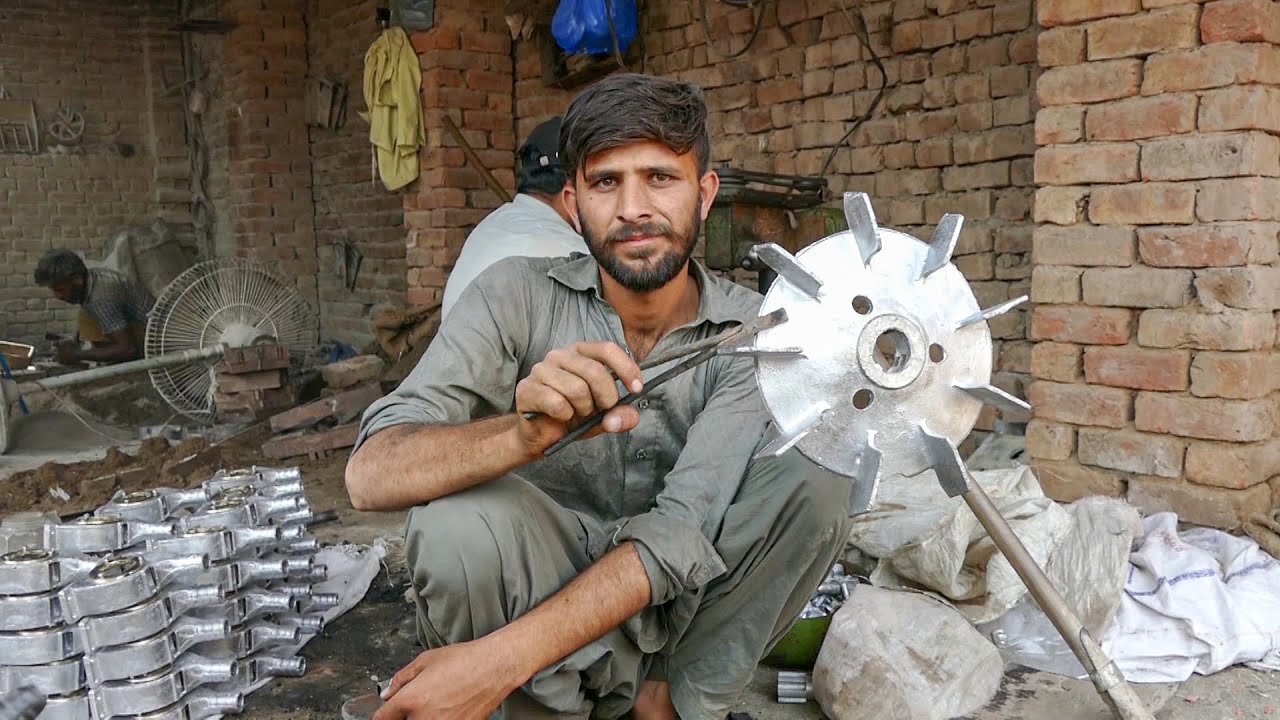

I bet you can get something that works. It most likely isn’t going to be as easy or as nice as the commercial stuff, and chances of doing it more cheaply because you can’t scale go down. NOW, that isn’t 100% true all the time.
For example:
This method doesn’t lend itself well to commercial production. However, I am interested in this technique, because I have a bunch of green branches and I have some aluminum. So now Kristijan is making me do some more homework like what kind of branches, how big and do you include leaves?. :stuck_out_tongue: but a youtuber like TheKingOfRandom, lives in an apartment, and wouldn’t have branches he could cut nor would alcoa want to harvest 1000 acres a day of small trees when they can buy a barrel of flux for a thousand dollars.

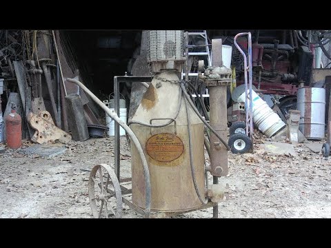

Every morning at work my employer has us sit in a meeting and they talk about safety ( talk is free action is expensive )
WE had one day where they talked about acetylene generators, gas cylinders and regulation about their use in mines.
I thought WTF??? is it 1930???
Who is proof reading this so I interrupted the speaker and ask the question where do we have these and what are we using them for now or in the past.
No one said anything and no one could answer.
Here is one of them.
Its not to say its the most dangerous thing to ever grace a shop.
But I would never use one…
My theory someone who had no idea what they were talking about sits and reads mining regulations and spits up talking points.
A talking head with no idea what they are doing but promoted because he/she gave a great speech in a meeting.
