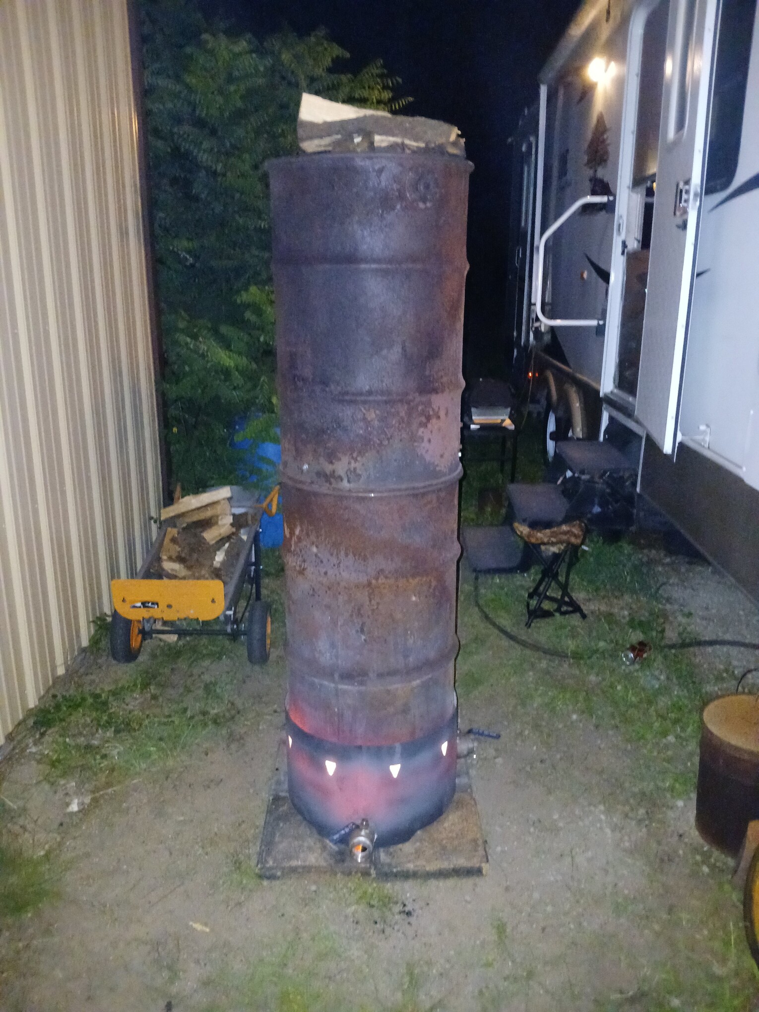

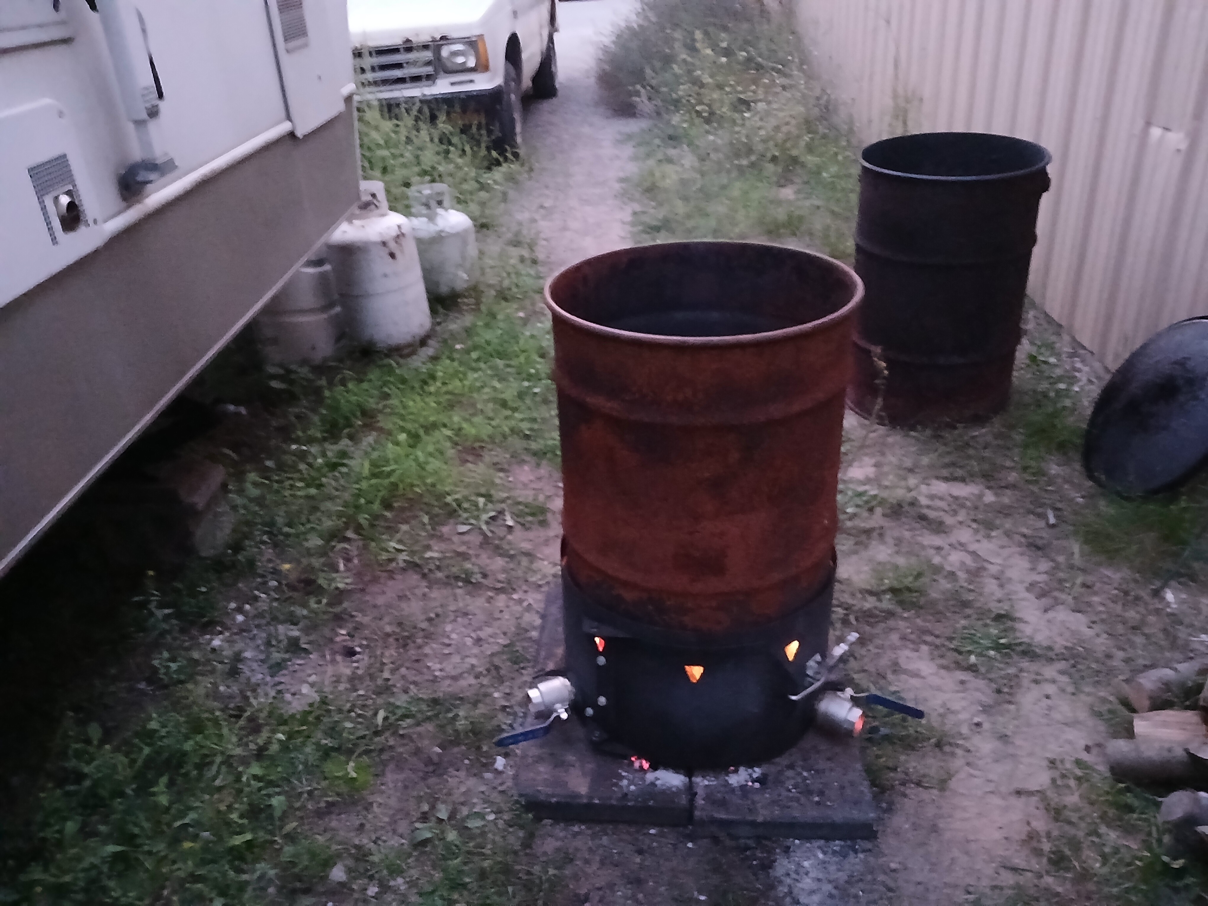

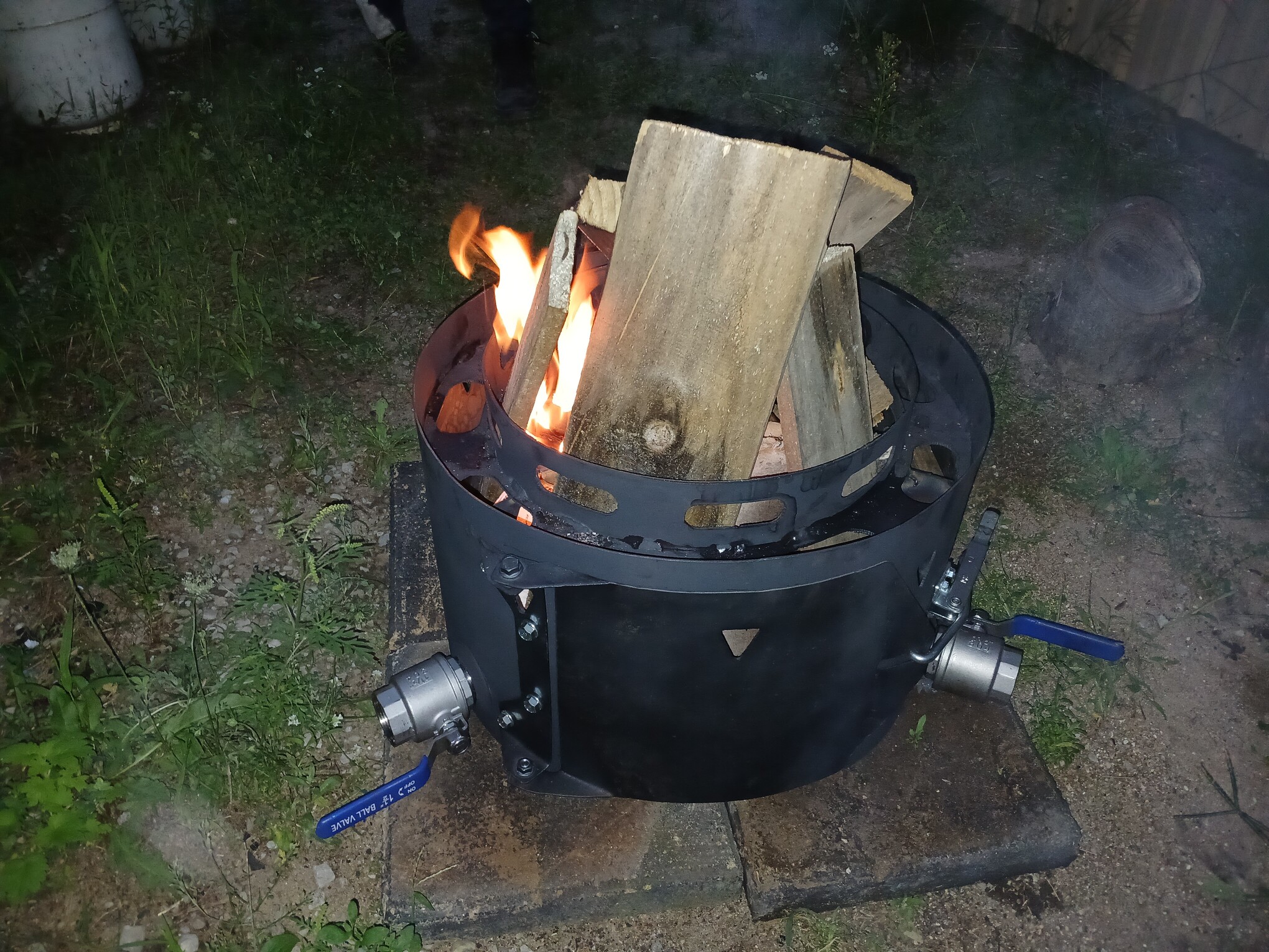

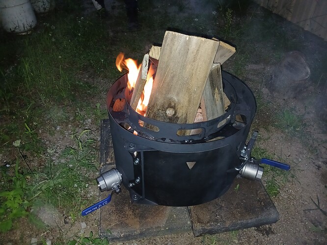

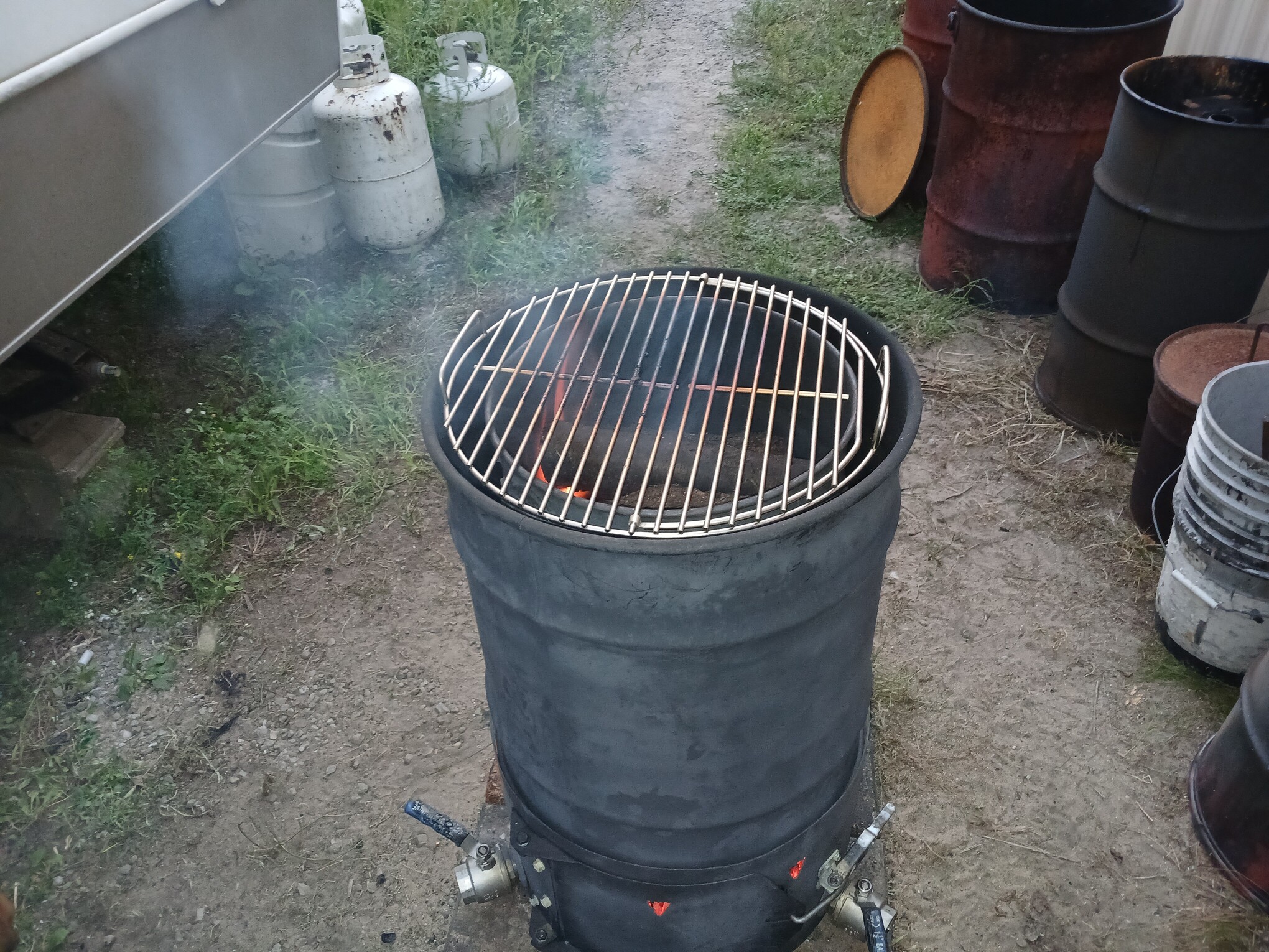

Ok so what I came up with; is a burnner base that we will manufacture and this will become its own product as this thing can be switched up to work as multiple devices. It works excellent as a smokeless portable fire pit. Ok now because its designed to work with the drums. You can get different sizes of the 14 and 19 inch diameter drums for it. You can use the short drums and make BBQ with it. Or a self feed hopper in fire pit mode. It can be ran as a single stage retort or add the both stages and then you have pre drying stage. Wrap a water coil and you got a water heater. Then it can be used for a shop heater as well as I do plan toi use this one this year.
The first proto was this size and that thing alone could nearly heat the entire shop. I used a torpedo heater to suppliment it. But you only need to run it for short times to maintain a comfortable level even on the coldest days here in Mich.
So this I think is much more viable and also marketable as a product. With its versitility I think it deserves the VersiFire branding. VersiFire I own this brand already so its not just name I came up with I own the domains for it. So Im going to use it I just needed a product to fit it. This I believe is that product.
So from now on all CFX RTR with the new price point with get a VersiFire burner / retort kit. But this will also be sold stand alone and its own product. Base will be just a fire pit. Then Ill offer the retort kit parts and drop ship the drums with the full kit.
So now all the user has to do to DIY this is cut the bottom out of the 30 gallon drums and simply drill the holes in the retort bottoms to addapt the center vent pipes and I even provide a steel template to locate the holes center on drum. So if a user cant build this, they probably shouldnt be messing with a gasifiere in the first place and thats a red flag they are not educated on the tech and may have expectations what the technology can deliver.
Ok so how this evolved: So I came up with the burner idea and its based on the concept of the two stage retort Ive been developing over the last few years now. Seems like its been a short time but I did build the first proto two years ago already. Anyways. after I built it. Im thinking man that might make a great portable fire fit. So I tried it, then more ideas came. I can put the lid directly on the burner and forces the gas out the vents and make it smokeless? Yup sure can it works. Then Im think well what if I put the shorter drums on it I could put a 18 inch grill on the inner drum and outer will hold it place. Yup it worked!. Oh yeah put in smokeless and let it burn it makes charcoal on the spot for grilling. Remove the grill now the inner drum is a hopper and you can fill that with fire wood and put the lid on and it will self feed for the entire night. Oh need it to produce more heat? Yeah just place one of the outer shrouds on and that will draft it much harder and stoke it up. You could set up the retort shround with a water coil to produce hot water daily and that would be a great incentive to use it to make charcoal plus a cool burner for the warmer months this is your fire pit and then its a shop heater in the colder months.
So if it can be used on daily basis in a practical way, You can amass a lot of charcoal over time and will have plenty of fuel for suplimental power and back up and this is then just not limited as a charcoal producer. It has many other practical uses and its actually fun to use. This will be a much more viable product worth of the VersiFire branding that will appeal to a much larger market than just a small select DIY gasifeir market that I dont see being very successful.

Nicest valves I’ve ever seen on a fire pit :slightly_smiling_face:
One of the nicest fire pits, too . . .

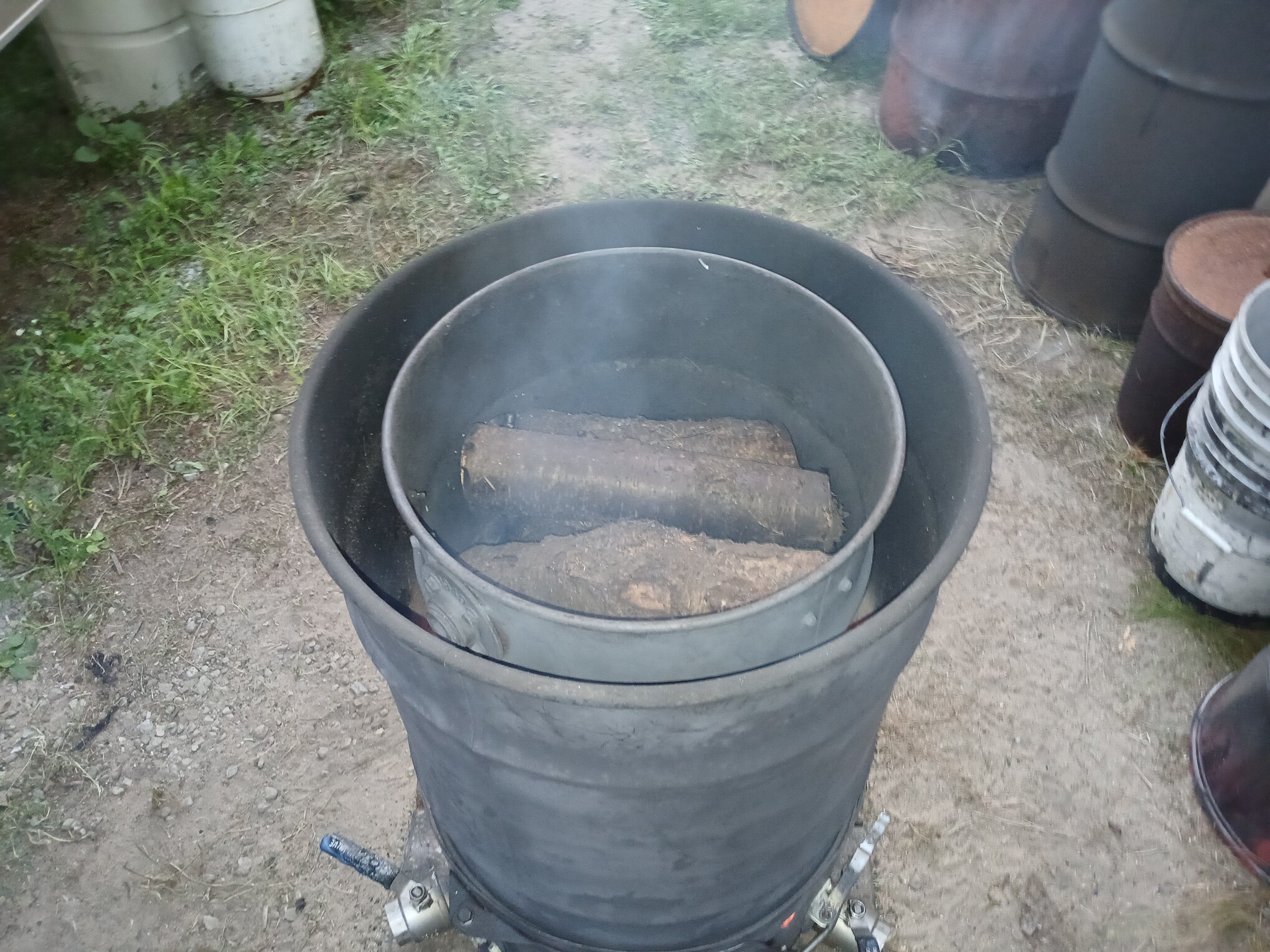

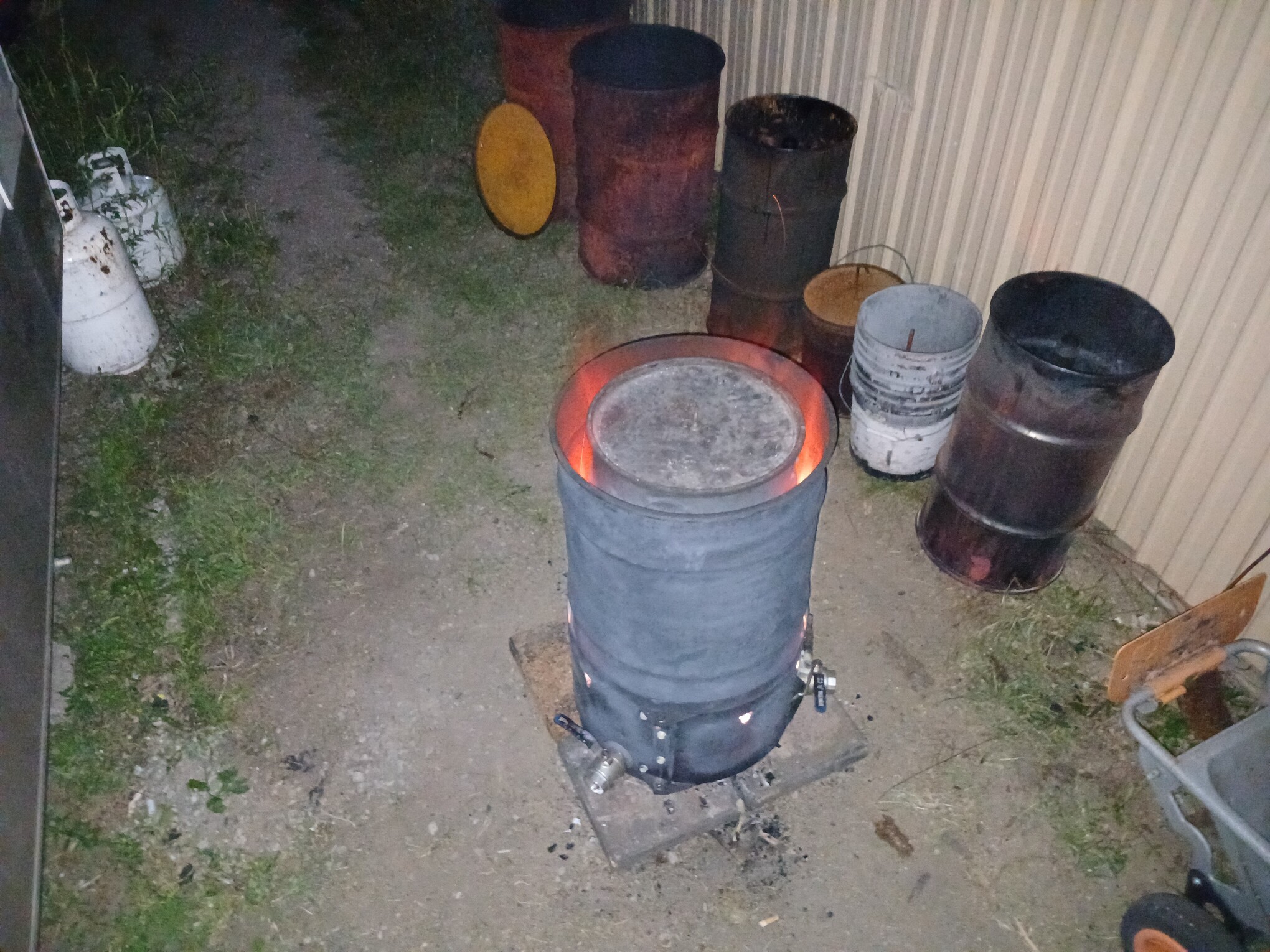

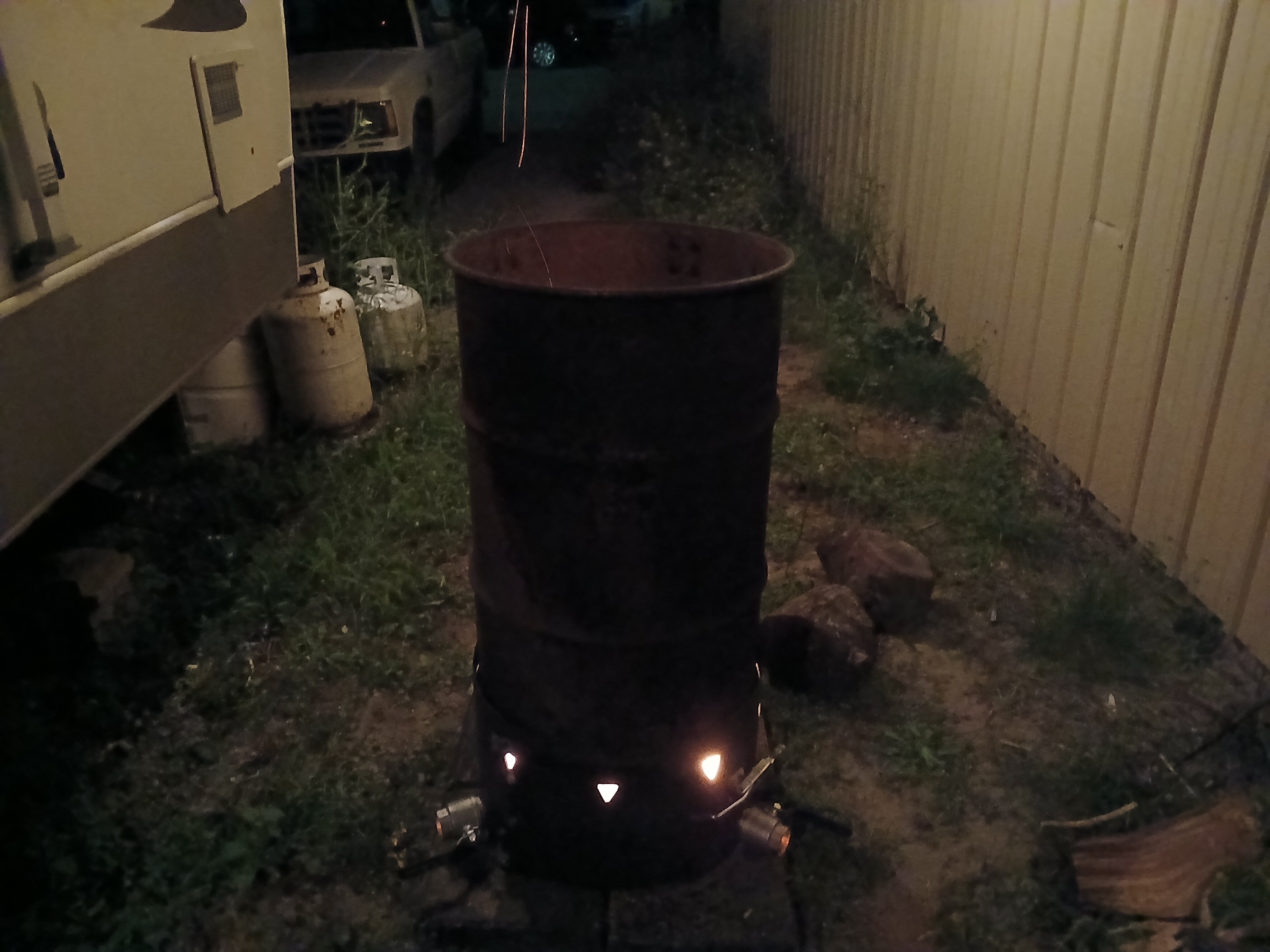

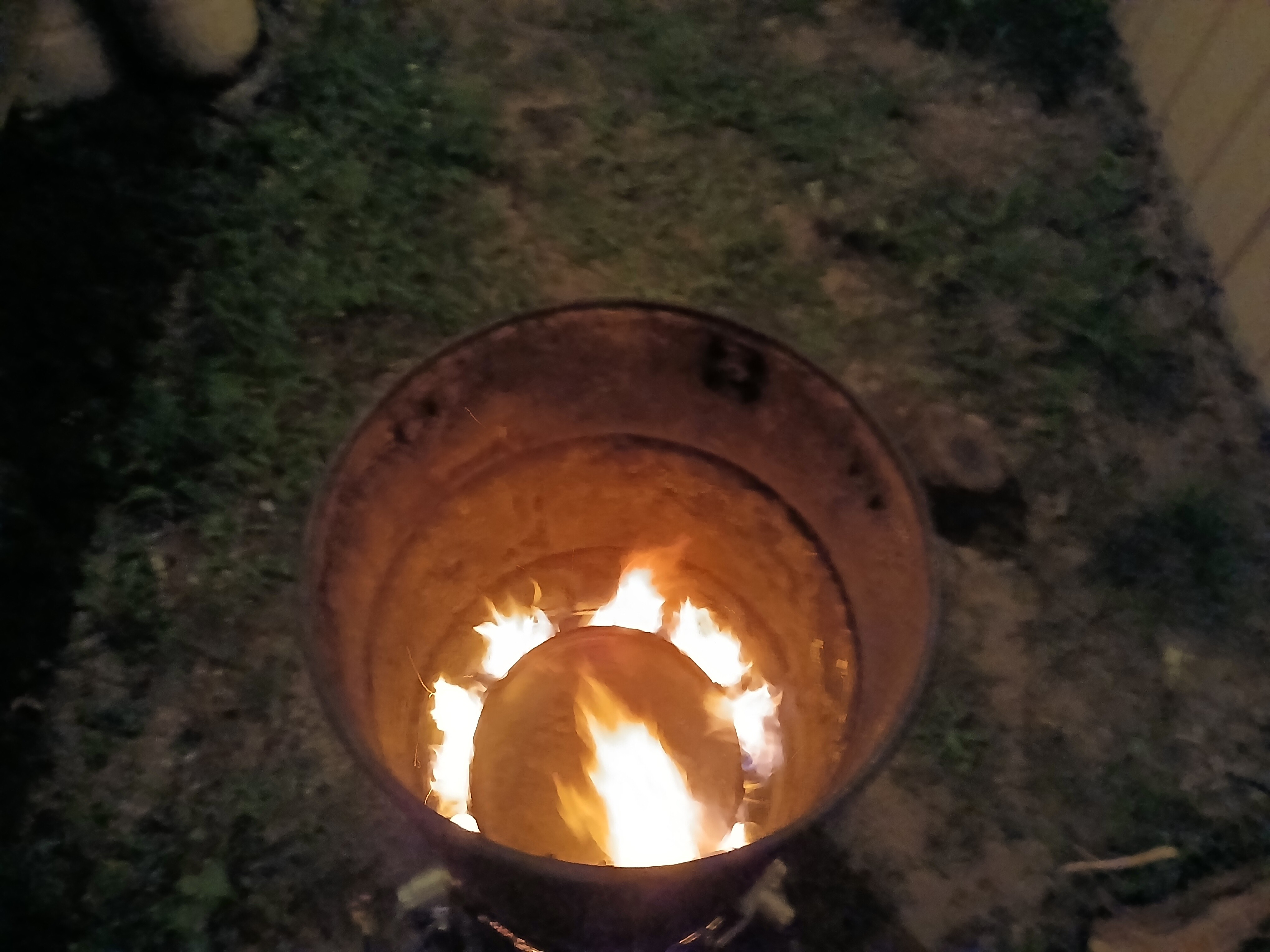

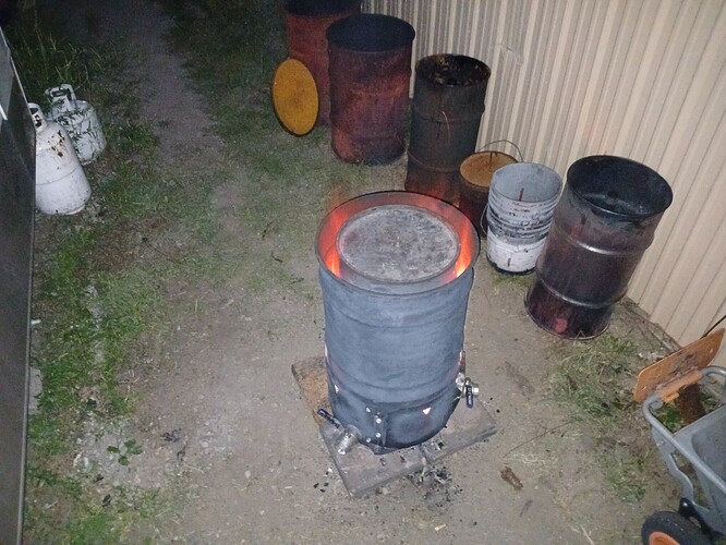

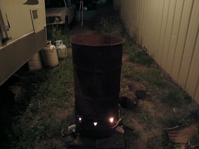

I did the video today and ran it for the first time in retort mode with the second stage. Once the burn chamber was at full combustion and the first loading after getting it lit it took about 55 minutes for this wood to gasiffy and it ran for an hour with the valves reduced nearly shut. This wood was cut a while ago like a year so but was just split today so it was not fully seasoned. I think its a mix of cherry and maybe some burch I dont know. Its what I got :fire:
So thats pretty impressive its faster than the big one. Id rether run two or more small ones then one big one.
post deleted by author

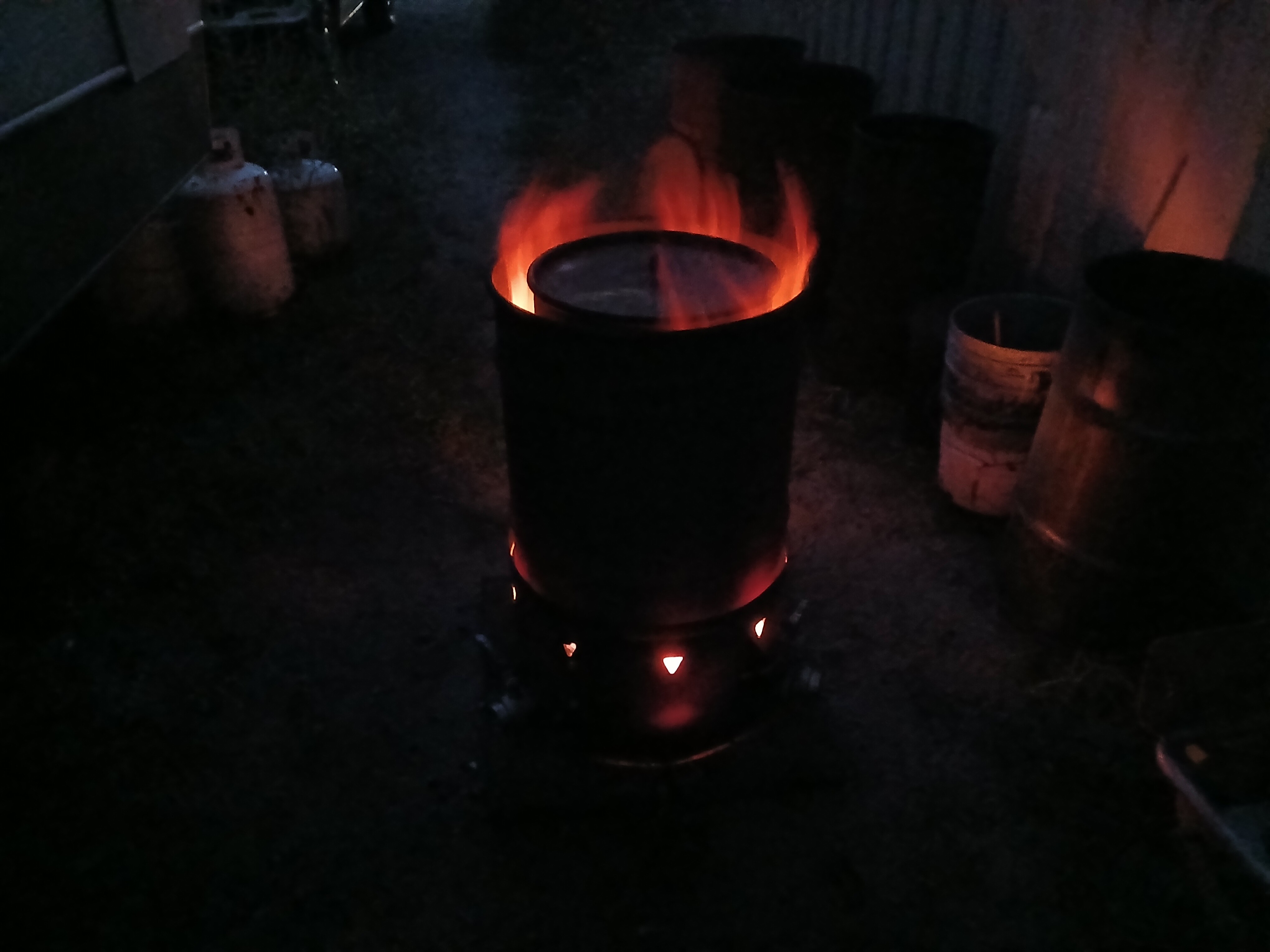

Ok well checked the retort today and it wasnt done. So what I learned is that is just when its getting started. When it died down it just needed some more fuel is all.

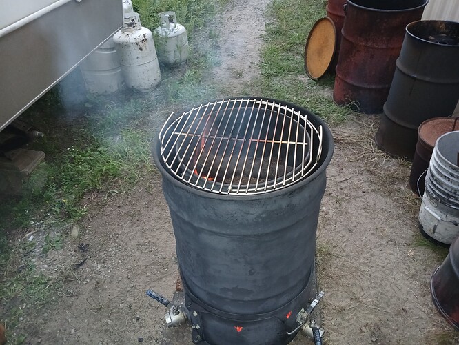

So today I ran that last batch and then emptied the fire chamber and let it cool. While it was cooling I referbished some shorter drums to convert it into fire pit / BBQ mode. So once it cooled I dumped the charcoal and set the top kiln aside and set it up and made dinner on it:) lol this thing is awesome!. Then I converted it back to retort mode and there was a good char bed in there already to go from making food. So flatted that out and laid fuel in there and let it. It started gasifiying on this first batch and died down around 45 minutes without any fuel added. So then I loaded again and it shoot it took off!! I was little concerned there for a minute. I shut the valves off and those top tiers were enough keep the gas produced hot enough to run away. It was really rich lots of smoke and that thing turned cherry red!. Once it died down it kepted on gasifying, so I kept loading but less this time. Haha! and I could control it with the valves and it just kept going. Started at 9 pm and ended at 11 pm. This time I think its done. Im interested to see the top I think it may be done too. haha. It didnt use very much fuel; the ratio Id say is somewhere between 40/60 to 30/70 gross feed in (What Goes in fire box / what goes in retort)
I wieghed the charcoal it last made. These drums are 16 gallon drums and this run the yeild Id say by looking at is around 10 gallons. The wieght was 14 lbs.
The fuel in the kiln stage wieghed 42 lbs. I dont know the raw wieght going in.
Ill be posting pics of the Fire pit / BBQ set up soon. I have a grill grate coming tommorrow for it. It makes its own charcoal. You just need to put some wood in it and burn it down. It works a bit like a TLUD. Plus fire pit mode with the center drum hopper.
Took a break from charcoal making and ran it in fire pit / BBQ tonight. Its pretty cool and burns really clean.
