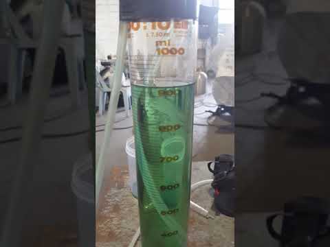

I am going to use this 13 Hp engine/generator set to do some baseline testing to compare fuels and consumption under different loads
The clip here, shows the engine running under 5 Kwh load
I have tested under no load, 2 Kwh load, 3 Kwh load and this under the 5 Kwh Load.

Consumption of E20 fuel ( as per oem specs )
No load: 1,32 Liter/Hr
2 Kwh load: 1,84 Liter/Hr
3 Kwh load: 2,4 Liter/Hr
5 Kwh load: 3,24 Liter/Hr
