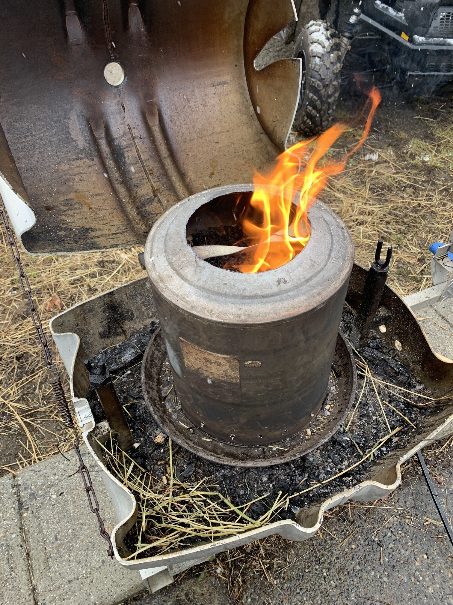

Wondering if anyone has built a gasifier stove for making charcoal instead of a retort? Would a retort work better? I built a gasifier stove from a poultry drinker yesterday and all that’s left after the burn is charcoal. I feel like the gasifier wood be less wasteful as you wouldn’t need to burn any wood that wasn’t been used for the charcoalling process.
Hi justin, the tlud stove is a gasifier stove really. A lot of charcoal gasifier people use them to make their charcoal. I started that way but eventually your addiction to charcoal grows beyond your need for cooking and you make something bigger. In my case a 50 gallon tlud…

All good. So yes it’s a retort with good air control. It stands for top lit up draft. You light the top layer and create a layer of hot charcoal which breaks down and fully combusts all the volatiles coming off the wood below. The heat layer moves down and converts it all to charcoal. Then you cover or wet the load once it is all charcoal or burn it down to ash if you prefer.
