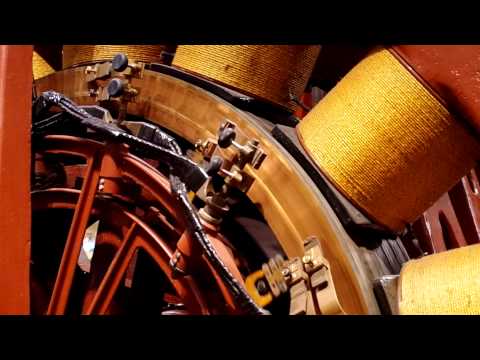

https://youtu.be/10wdqjT3w9Q here’s a great link for what u are talking about…I’d like to pick ur brain on this
