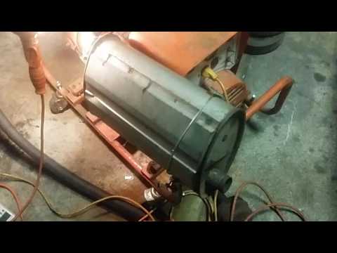

Larry, I sort of do that only with a regular 5500 watt genset running on woodgas off from the filter barrel on my Geo Tracker. You could have a dedicated engine running car alternator (s) belt drive to charge batteries also.
Hi Don,
Thanks for the video, I like that big muffler you put on your generator!
Have you ever checked to see how close the frequency stays to the target of 60 cycles when the load changes from light to heavy while running on woodgas? What you are doing would probably be ok for running power tools and such but I would have concerns that things like the refrigerator compressor, computer power supply and LCD TV might be damaged if there was too much change in line frequency.
