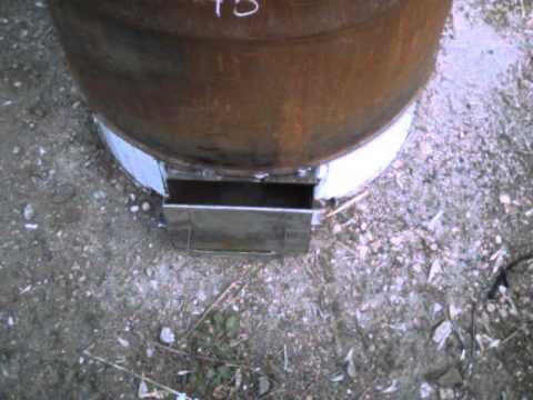

Up here in the cold country we spend more money on heat than we do on gasoline. I have heated my 1500 sq foot shop for 42 years with wood, that’s a lot of wood handling. My interest in the sawdust stove is in the time between fills. My current three pass stove needs more wood every two hours. the sawdust stove has been running four hours now and is still going strong on the first fill, one 30 gal drum of sawdust. I will update this post when it goes out.

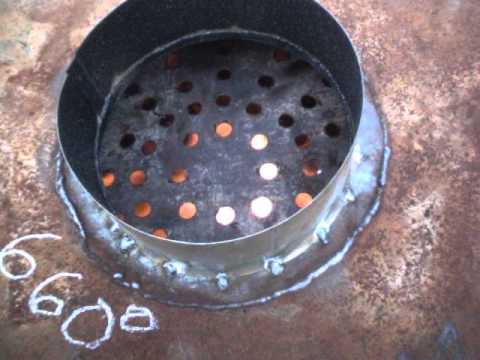

Richard I used sawdust from a 12 inch circle saw. I used the plans from the link but I moved the smoke stack to the top and and used the hole from the side stack to add air to get a top burn to clean the flu gas.
“secondary burn” This also allows me to control the stack temp. I plan on using a, forced air, heat saver on the stack.

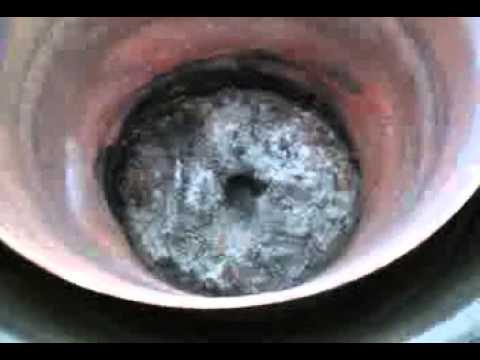

Ok I opened the sawdust stove up after the burn and made a short video of what was left of the fuel.
