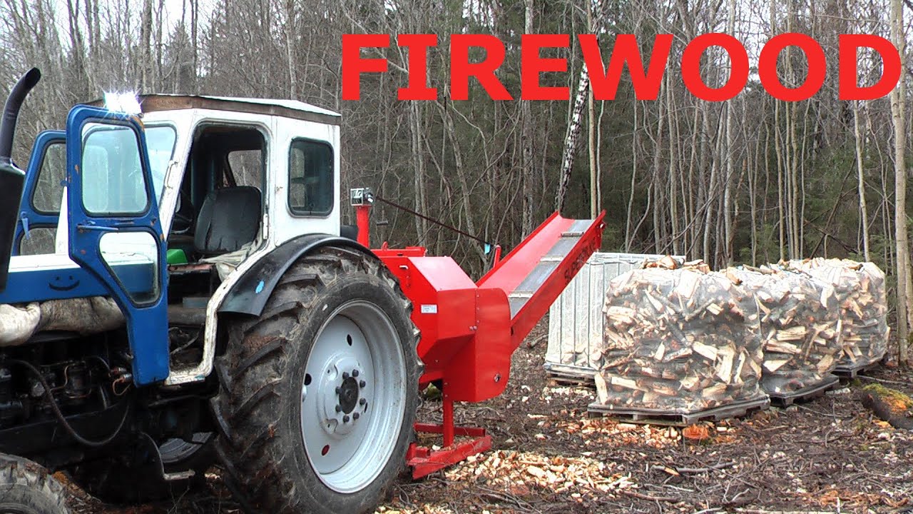

Second video was quite interesting, he stated something that my father had read many years ago that the heat energy of all species of wood was the same…based on dry weight. I would like to know if what he did to the machine was a modification or an adjustment. My instinct thinks it is a modification to allow for a radical adjustment.
Hi Wyatt,
as far is I know he modified the crank mechanism in this chunker. This mechanism drives the gripper drum that pull the wood in the chunker.
So less stroke on the crank means shorter chunks.
The crank can be seen around minute 2 in the second video you posted (post #3 superpilke firewood processor)
I just replaced the second video with an even better one showing the internals of this type of machine.
