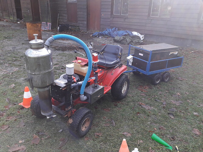

Senne's first gasifier for a 12hp riding mower

First tests are done,
Hooked up the trailer behind the mower. Then I locked the governor and measured the time to travel from point A to B (small distance slightly uphill).
Next time more thorough measurements! I’m hooking up an RPM sensor soon. I will try steam injection and better methanol injection. Also A/F ratio was probably not ideal aswell.
One conclusion is definitely that methanol gives richer gas which was to be expected.
-Senne
