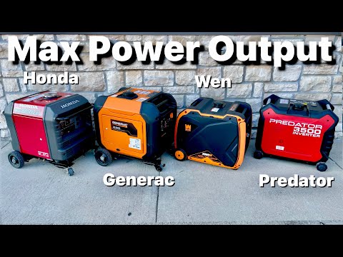

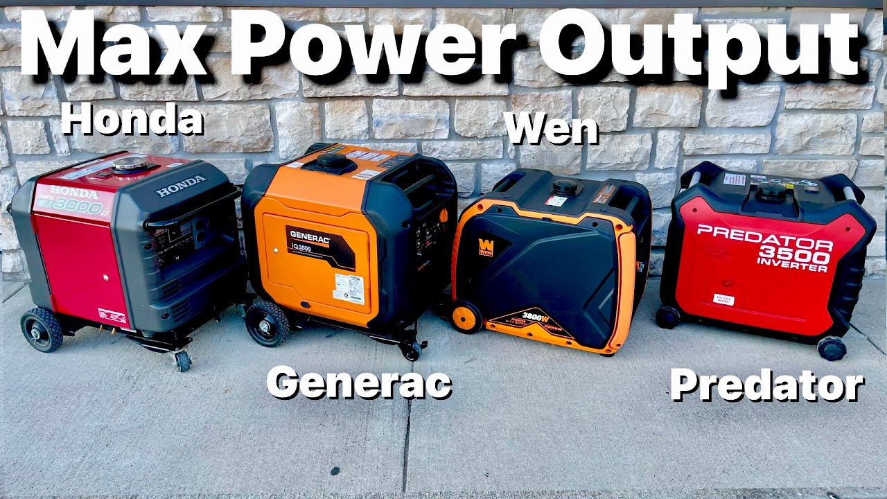

The Honda series of engine driven inverter-generator units are worldwide. So available in 50 Herz. Our small Honda EU2000 suitcase unit was a gift to my Wife. 98cc engine. Redesigned now as a 2200 rated unit with a 125cc engine.
Their larger 3000 series units are more versatile. Some true off-grid living here using these as winter season PV solar fill in power. With frequent oil changes, unit good for year after year.
My Yamaha EF2700 is an older open frame design. 172cc? as I recall. Rated higher it still will not start up many electrical motors.

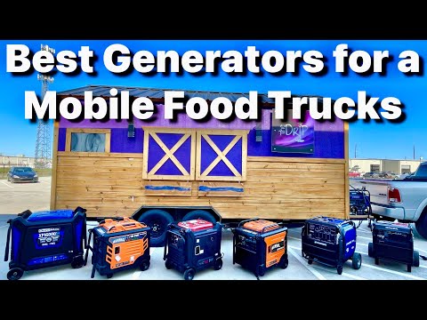

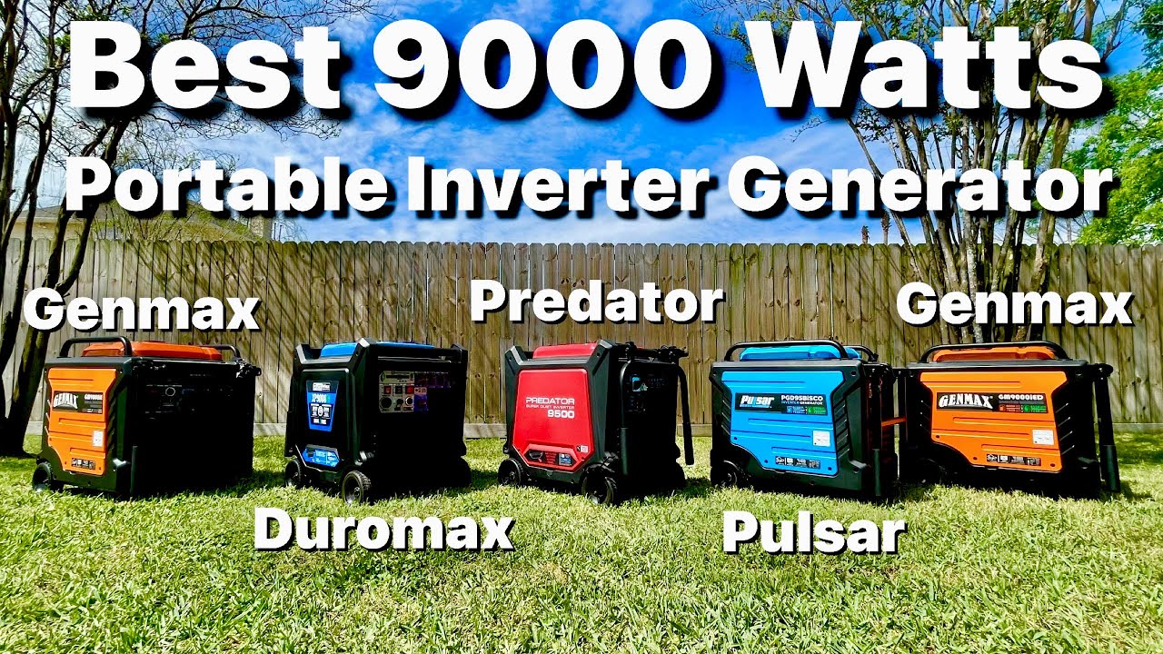

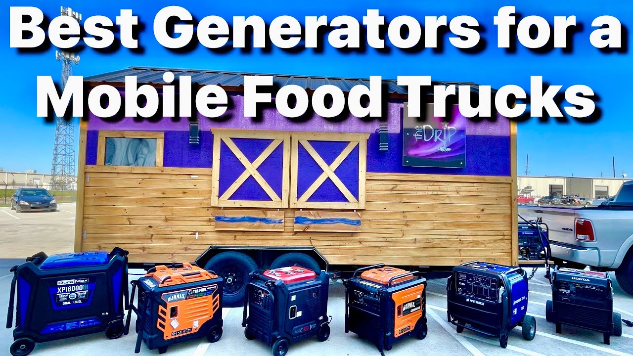

The big 9500/7600 watt made-in-China unit is sold here in the US through a tools retailer Harbor Freight. Canada, Princess Auto. 459cc single cylinder engine.
There are many manufacturers and suppliers in this size range:
Me, Dave, and others wish for even larger units that would have V-Twin air-cooled engines.
Woodgasing is much easier done on multiple cylinder engines. Finally the very new 744cc V-Twin DuroMax 16,000 watt unit in the second video. Gavin now with three videos up now on just it.
