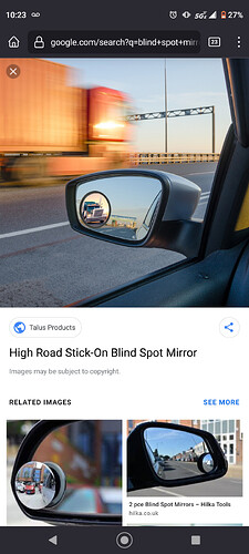

Also if you do add the wall, I would put these on your side mirrors so you can still see behind you. I have them on all my vehicles regardless.
