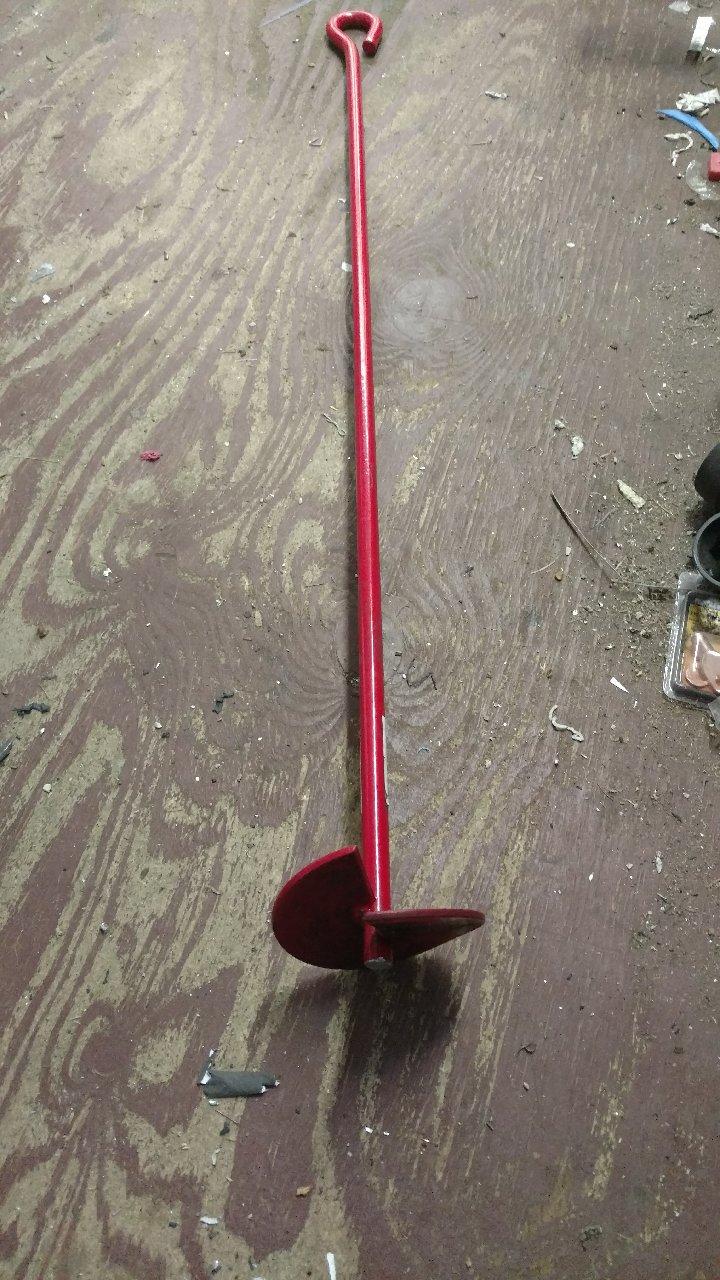

I was reading down through this old topic as I’m designing a new gasifier for Africa. This discussion went a little sideways about the difficulty starting up on previously run charcoal. Then I saw this screw in earth anchor at tractor supply.

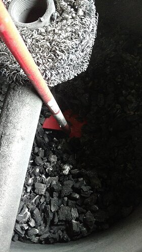

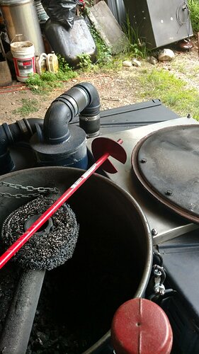

I thought it might auger down to the nozzle in my MGB to lift old charcoal away and let fresh char fall into place.

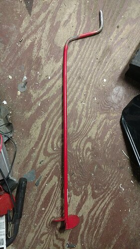

After giving it a try, I made this modification:
