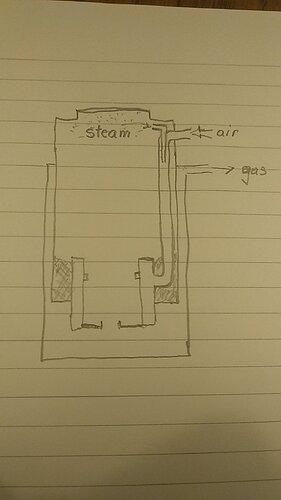

Kristjan, I’ve been thinking a bit about mixing water vapor in your system, you use moist charcoal but the drying takes place over the hot zone and the humidity rises up in the center of the action and only dry air is blown in. Your gasifier has air intake through the pipe from the top, if you added an opening for steam entry on the inside it could improve the gas.
