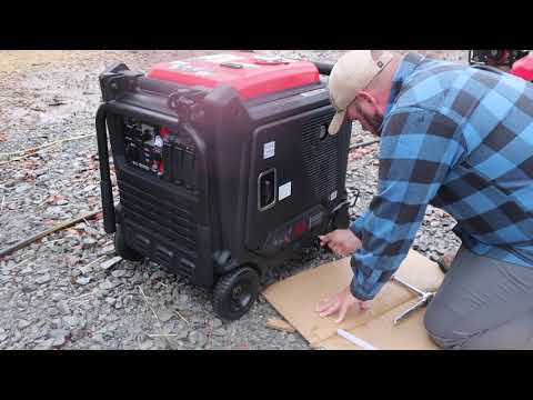

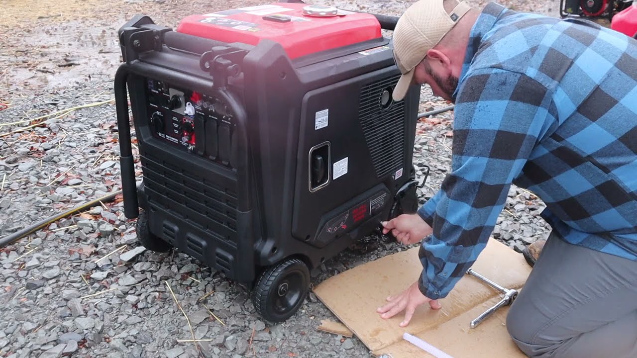

Here is an unboxing and first 20 hours working loaded running of a Harbor Freight “Chinese” 9500 inverter-generator unit.
Here is the very interesting part. This guy is a mobile portable metals welder. He wanted something powerful enough yet balls-out-safe for his wide variety of inverter welders that he uses. Open up and view his channel for all of that.
Now. How to fanatically get 3X-4X of the manufacturers intend 400-1000 hours service life on one of these modern precision built air cooled 4-stroke air cooled engines.
  1. Change out the first non-synthetic oil at no more than 5 hours. These modern precision mass produced engine are actually usually been flushed washed clean of casting and machining particles.
    But ALL moving metals parts will have wear matching-in; breaking-in metals particles shedding off. You want to remove this while in oil suspension before it would imbed into soft bearing faces and cause ongoing usages wear.
  2. Then change out oil again at 15 hours total running time. Same-same reasoning as in #1.
    Still use non-synthetic oil.
  3. Then dump out that second oil change at between a total of 30-50 hours.
    Then you can refill with a quality synthetic oil. Loaded running these air cooled especially in the summer run hotter than a water cooled engine. Synthetic oil has better heat resistance breaking down.
  4. Now oil chang not by times intervals. But by the oil darkening from heat changing and combustion contaminates building up. Many of these combustion contaminates are acids. It is clean oil that delays off engine wearing.
    Oil changing fanatical I get years and years; and thousands of hour longer service lives than by-the-book types.
    Worn out is hard starting. Smoking running; and excessive oil contamination. Excessive spark plug fouling. Low produced power. Higher fuels consumptions.
  5. Change out spark plugs at recommended hours intervals. Before the need. Weak spark; and misfires causes heat and electrical shock over-loading on the ignition coil and ignition electronics. Causes faster oil contamination from the incomplete combustion.
It you stop treating these as throw-aways, then they will serve long and loyal. You will save many $'s in replacement costs.
