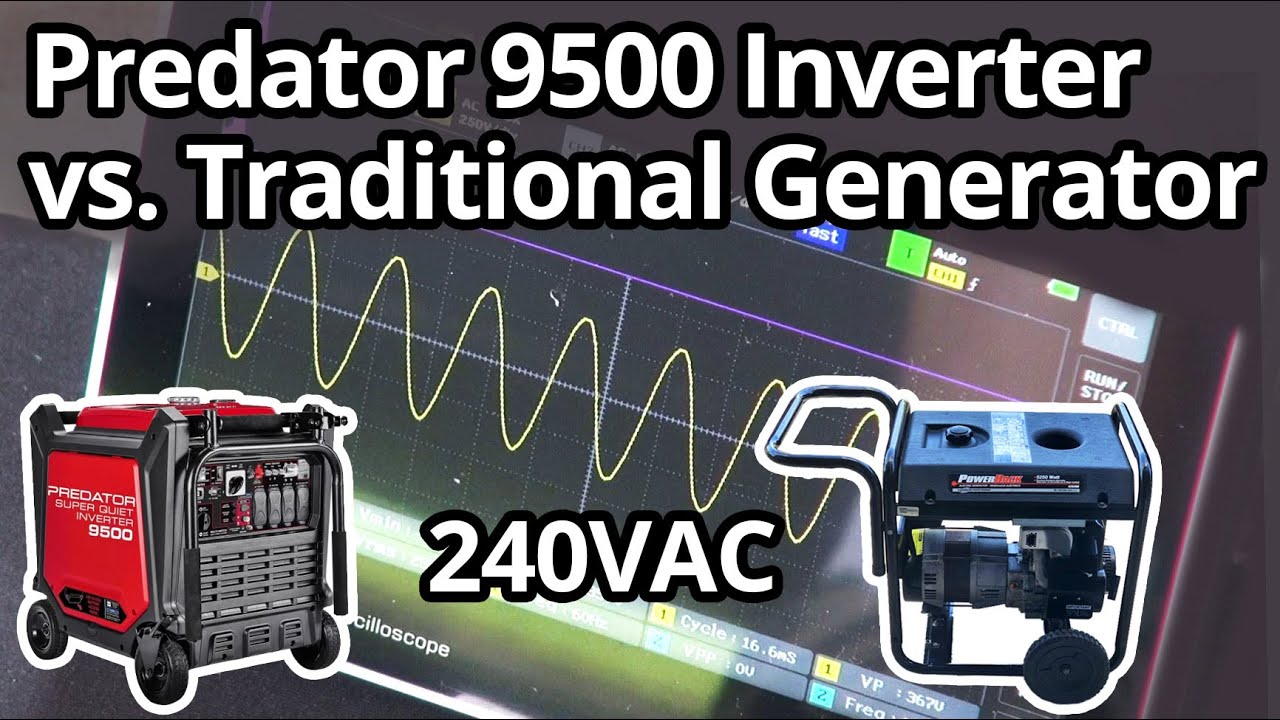

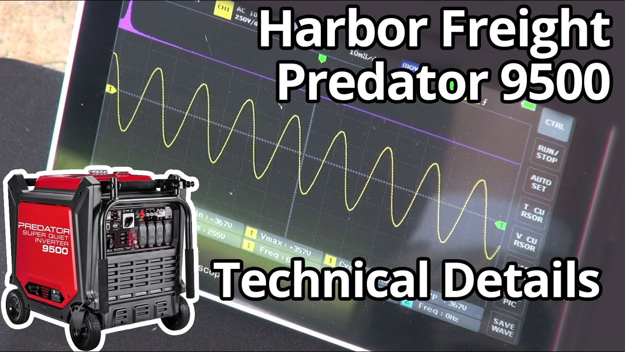

Hi All,
Here is another Predator 9500 inverter-generator video with relevant info in it.
Pay attention to his added magnetic plug metals found at the first two short interval oil changes. This is real. Real on all of the modern precision mass-manufactured four stroke engines I have new put into service in the last 20+ years. Why I became so early-then change it out fanatical in the first 30-50 hour breaking in. I could see the glitter in the bottom of clean pans drained into. Much of that glitter is aluminum non-magnetic. So get it out with oil changes.
Second pay attention to his monitoring system runout of fuel output voltages and wave patterns! This system does not weird-out voltage spike or sag harming supplied devices. All direct driven synchonous will do this.
These points. Plus the fact an “oversized” “fuel-hog” large unit like this 9500 or the DuroMax 16,000 will not actually hog gasoline or propane because they will run mostly in low RPM Eco why I can say just sell-off, gift-off your old 3600 rpm screamer and go-forwards invest in a proven quality brand of engine driven inverter-generator unit.
Looking forward to DIY fueling it on wood.
I did once pay $4,000 for a new Miller 10,000 watt Trailblazer welder-generator. to get the more fuel efficient EFI. At no-load low RPM it would still eat nearly 0.4 gallon of gasoline per running hour.
Great unit. Would have been super expensive to ever have to repair down the road.
As this guy says; a fellow could buy TWO H.F. 9500’s and then have the safe power.
With a half system then down still have some safe power as your belt to go with your suspenders.

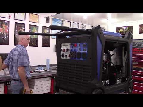

Hi All,
I am going to post up this longer DuroMax V-Twin 16,000 inverter-generator here.
I watched in detail not for the fellows extended running install kit but for the from many angles viewing of this systems insides:
Very generous room inside this system versus any of the large single cylinder 8000-9500 units.
Ha! you can see the same cast aluminum corner posts system.
I’ll be watching these for users usages accumulated usages. Saving back now money for one of these myself. Ha! Take me about 9-10 months.
