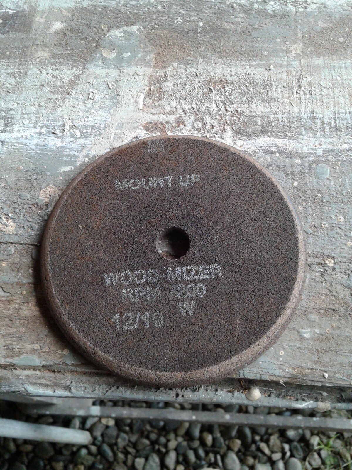

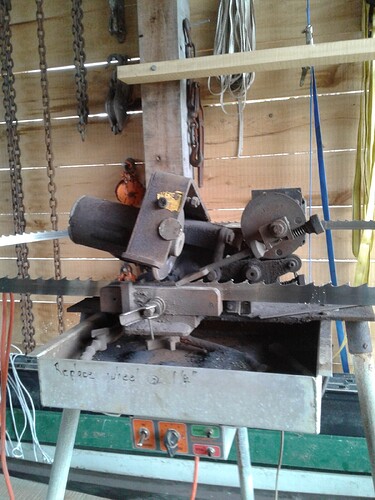

This is my blade sharpener and a grinding disc.

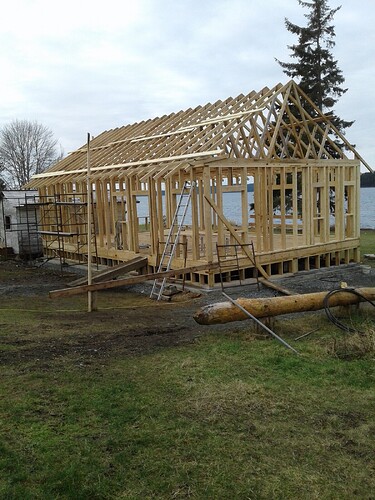

This is the retirement home on the beach with all the wood milled on my mill.

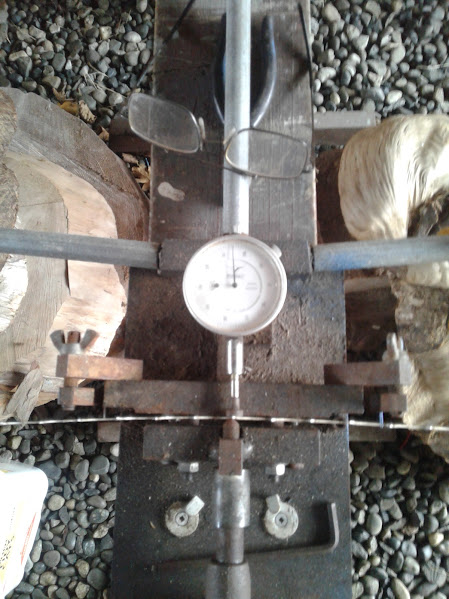

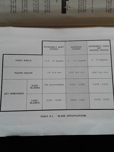

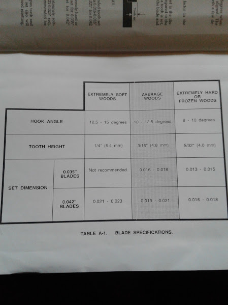

Here is the toothsetter and paperwork.
Thanks for all the pictures, I have saved them so I have them left. What a nice location for the cottage you are building, you can sit on the porch and fish.

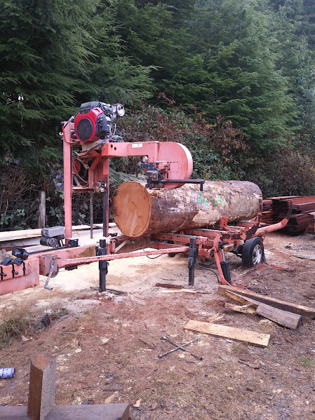

Here is my mill with a bigger log than I usually cut.

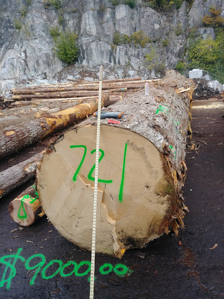

This is the biggest nicest yellow cedar I have ever seen. Came across at work a couple years ago.
Good, pictures say a lot, nice sawmill, so there Logosol made its first sawmill, (a Swedish company), it will not be unstable in the outer end?
I got lucky. A friend of mine bought it off his neighbor . He was a farmer that bought it new and ran it for a couple hundred hours and then it sat in his field with trees growing up through it. I had a smaller version but sold it when I bought this one and put a Honda on it and cut lots with it. Wood Mizer have made these cantilever mills since 1982 and they work well especially if you keep the blade sharp. They are starting to sell more 4 post mills now. I saw the logs you have cut at your place. What size boards are you cutting for your big order? I mostly cut 25x150, 25x200, 50x150 and 50x200.
