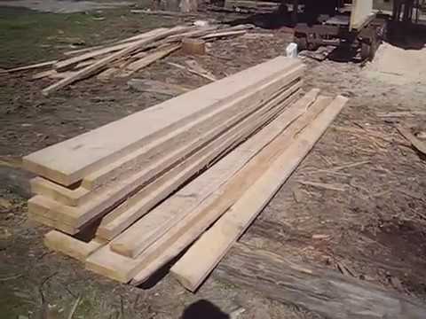

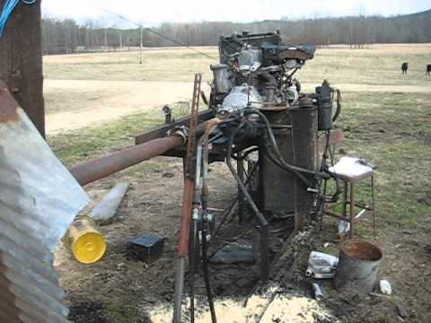

Hello all . We have had some interest in sawmills so I thought I would start a topic on them .
Below are some info on my junker .
I use a much smaller cordless drill for sharpening now .

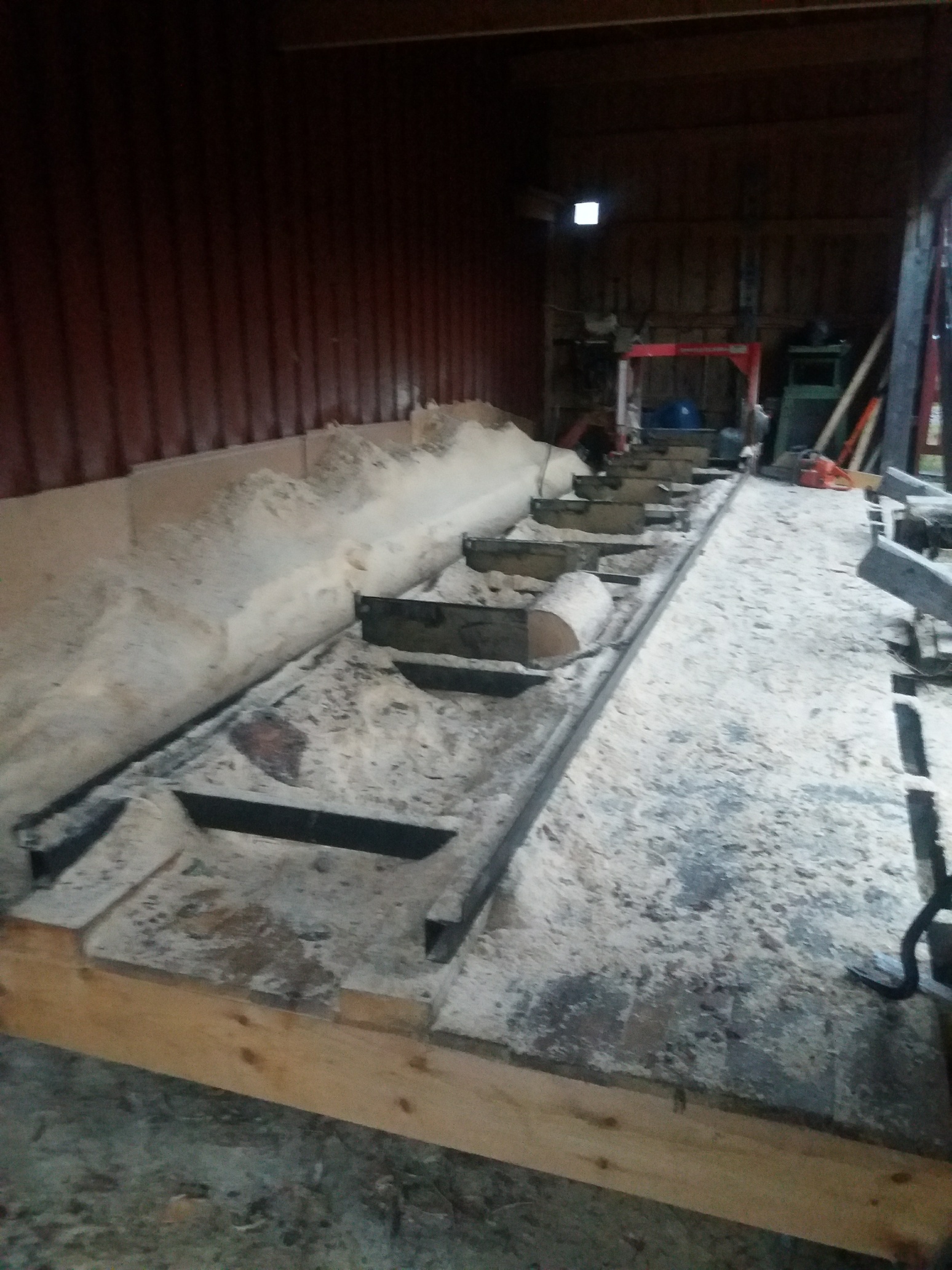

Hi Wayne. I saw the first video sometime back but didn’t understand everything I was seeing. The other ones solved that. I have a mill I built. I posted a picture of the carriage somewhere here. Not nearly as elaborate as yours. The carriage pushes through the log on mine like most of the homemade ones. When I set it back up I want to get more track made up and run the log through it on a carrier like you do. When I am pushing mine through a log I generally have to slow down if I hit a big knot or I’m afraid I’ll break the blade. You ever have any problem with your feed? I would like to eventually quit have to walk that blade carriage or trolley back and forth for every cut. Just haven’t figured out a good way to to that yet. I’ll post some pictures of mine in case some of the details would be of use to anyone building one of their own. I’d like to see how you get a log that size flopped around to get it squared up before you start cutting boards.

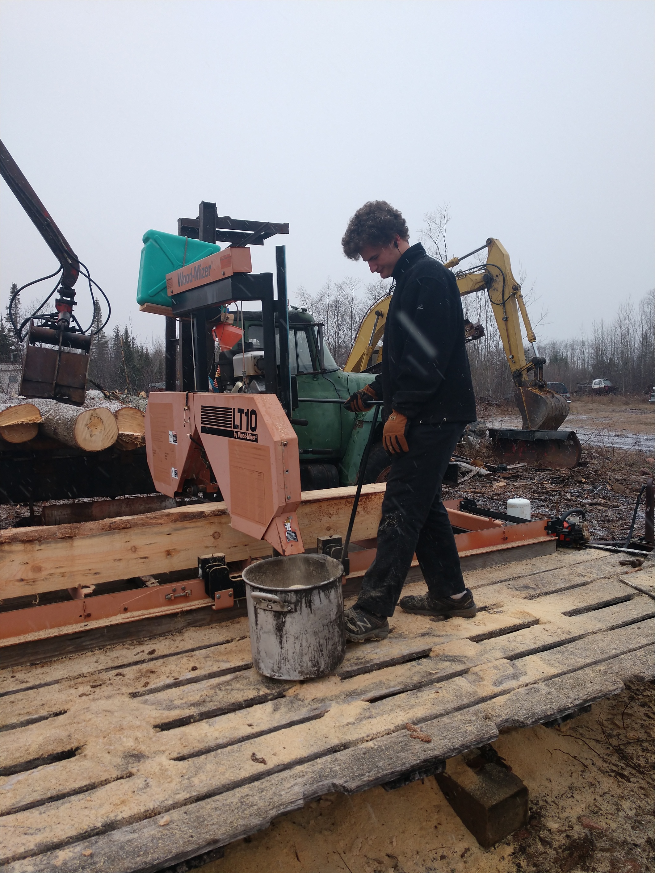

I dunno if you encounter this down south, but the day we were cutting this white pine, it was well below freezing. The man we bought the saw from said to use water to lube the blade, but we couldn’t keep it from icing up. I found a jug of wet transmission fluid in the back of a junk truck and I poured that in the drip tank. It seemed to clean off the dust from the blade and the belts and blade didn’t slip, so I suppose it was a win.
I wonder what we are supposed to use?
I use diesel fuel in a little squat bottle to clean the blade just a few squirts after each pass. Maybe it isn’t the best but several people who have done alot of sawing recommended it to me ask it cleans pine and other pitch off really quick. I squirt right at the blade guides. Seems to work best there to clean things.
