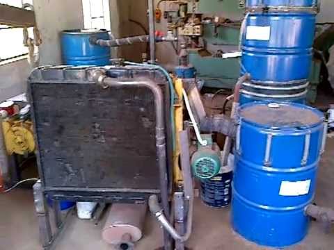

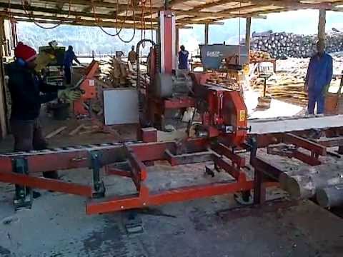

Patrick’s SA sawmill, as of 2013.
Thanks Mike. I had never seen that. ( Don Mannse did you notice the spacing on the ceiling trusses? Not much of a “snow load”) TomC
