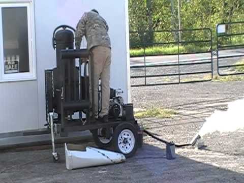

It’s been awhile since I started our little gasser so I figured I’d video a normal start up.

Engine started on the first try, it’s a thing of beauty
Hi ArvidO.
Just finished your video. Good job showing the process.
You certainly got the majority of the “other 75%” down on this system.
Nice clean engine starting up. What most only seeing this video will not realize without seeing your previous is that you are doing this on wood chips. This is rare in compared to easy wood chunks.

another vid of starting it from this morning. wanna show that it’s repeatable. of course, I left a condensate valve open.
Our unit is based off of Stephen Abaddess’ Victoria, with much input from Terry Lavictoire and Max gasman.
i cleaned out out our gasser’s ash can today. had about two inches of good lookin ash/char across the bottom. that would be with over a hundred hours run time on it…

Thanks Wayne… I cleaned out the final filter this morning… all the way down to bare metal… well, you know what i mean. the bottom/first stage of filtering is char chunks… cleaned those out by hand… mmmmmm, tasty… all the dirt washed off with a little soap and water so it’s all good.
finally all back together with some plumbing changes so it should be less restrictive. with a little luck my son and i will run it this weekend.
