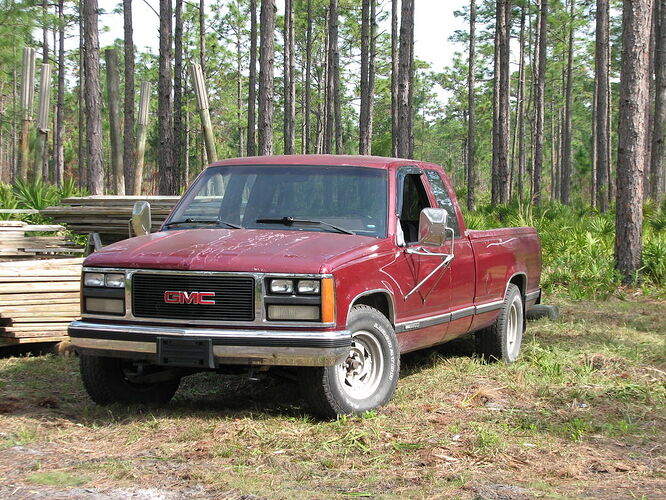

Hello Pete,
My first woodgas conversion was a 1998 Gmc Sierra.
Loved the truck and the memories!!! One problem it was from Canada. Salt rusted to the max and needed new everything. Working on a rusted truck is not something I would do if it could be avoided. Best solution I found is an Oxygen/ Acetylene cutting torch with a 1 1/0 tip. Not to cut bolts but heat them to cherry red then cool. The heat will eat up the rust and the bolt should come free. You will want to replace these as you go they are worthless. Hope this helps
Sean
