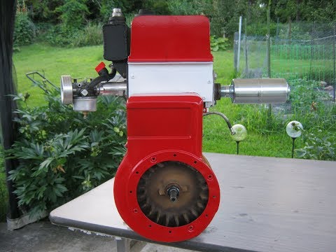

Careful where you grind on a clone case. The alternator bracked didn’t fit the way it was intended so I was going to modify the bracket. But tonight I got the smuck idea to grind on the case to make room for a boss on the bracket. Oh well I’ll steal an end plate from my parts engine. Dang it’s a bit beat, not nice and new like the one I put a hole in. I guess these are my training wheel engines. Maybe some day I’ll try to weld it…
Practice makes perfect…
Ouch, JB weld to the rescue!!!

Dang, two different versions. I have an old clunker but using it right now. I might have another old version in the box but not sure. I don’t know if Matt’s glue will stick to something that had motor oil on it. Would like to weld it but need the time to practice first.
The bolts point to the curved/flat spots. Plus a difference on the other side by oil fill.
Oh well…

JB weld will fix that right up. just wash it in gas or paint thinner or any thing to get the oil off.
There’s JB quick set and the slow set, the slow seems to work the best for me.
I have used it on all kinds of stuff and it sticks real good. It holds up to oil and diesel fuel, but gasoline will eventually soften it up.
Thanks Jim, I’ll pick some up and give it a try…
Thanks guys… All glued, assembled and torqued…
Oh, that Coleman gas did remove the oil from my fingers so it must have cleaned the patch area.
Did the bracket repair hack tonight. Now I caught up to where I was a month ago…

This was the day to start up the rig for the first time to break in the engine and see if the alternator falls off. This is only on gasoline and an old battery, no super caps. Inverter plus light for a load
First fill the tank with gas. I hate liquid fuels, spilled gas over the engine. Pull, pull, pull an no start. Looked like gasoline leaking out of the carb, dang Chinese or me spilling gasoline all over it.
Almost ready to pull the carb but went for the plug first. Ahh, oil from tipping the engine over to start it. Air hose was the only way to get the oil out but still no start. Repeated several times. OK, opened the carb bowl and drained out all the engine oil and it started second pull. :rage:
It all held together but this is just the start of the work that will need to be done. Used a 500w light but I do not know if it has a 500w bulb in it. When I find my wattometer I will measure it. The alternator ran amazingly cool, under body temp I would guess.

This post reminds me of a “fix” we had to do on Jakob’s go kart engine. He got a new predator engine from Harbor freight. They have a fill plug like this one on each side. To get his clutch bracket to mount we had to cut some of it off. We used red rtv to glue the plug threads in tight and let set over night. Then cut as little as possible with electric hacksaw through the housing and plug as needed. Did that to two engines now and neither has ever leaked.
