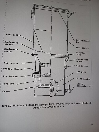

@Woodrunner what is the essential function of the hopper limiter in the chip gasifiers?
Is it the hole being smaller than the burn tube, or is it the smaller hole in combination with a voided area?
I would expect the voided area between the burn tube and the hopper to allow gas and air flow around the chips, to fluff it up as it were.
Very interesting that it basically has two condensation gutters as well.
Hi Cody, by hopper limiter you mean the “funnel” in bottom? I think it’s as you say there is a smaller hole in the funnel than the firetube. This was something they came up with to avoid all chips in the hopper rest on the charcoal bed, because it became to compacted/tight. This funnel supports the chips and also acts as part of the drying/condensing system. The “inverted funnel” shaped like a lamp-shade are a shield to lead condensate, following the funnel, to drip in the gutter along the periphery of the hopper.

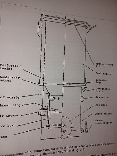

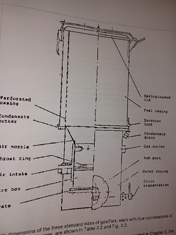

Late answer but i found some pic’s, showing differences.
Chip gasifier.
Same gasifier, setup for chunks/blocks.
It looks like just based on those two drawings, the small mouth of the baffle is roughly the same size as the nozzle tip circle. Very interesting and I hope that is the case, would be a very good rule of thumb.
