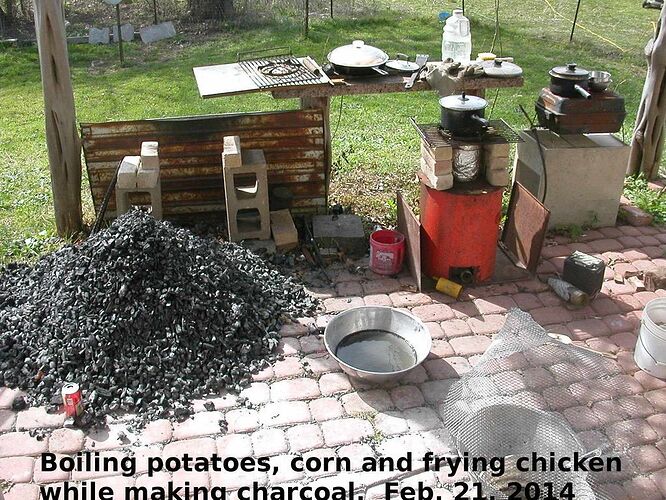

Here is a photo taken last Winter of charcoal made while cooking. (Dear Wife eventually requested that I remove it from the patio.) While I do make much more in 55 gallon drums (150 runs so far) I find little brands while sorting the output from the barrel charcoal that I can mix with the fuel for the stove to slow down the burn rate. The stove makes my best charcoal. I run it through my charcoal grinder, and save it as premium “stove” charcoal. Most of my fuel for the stove was chopped sawed/split a couple of years ago, so it is very dry. I made a slide show/video for YouTube in June of 2013. (Be sure to read the description.) https://www.youtube.com/watch?v=vHms7E0VAio&list=UUBQY_0L1cv262M14g92Rl4Q
You will notice quite a difference in the height of the flame if you compare my stove to Koen’s stove. The tips of the flames should just barely touch the bottom of the pan. You want to be able to stand over the stove and flip the chicken, or stir the stew, or stir the Wok, so the stove should burn clean with no smoke. Ray
Thats a great stove you have there, i definitive want to build one
Is flame color determines the momment where coal is ready?
Yes, the moment that volatiles are burnt, the color gets blue = time to quench
