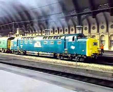

Here’s an Napier Deltic, an engine derived from the Jumo 205 and the Faibanks Morris OP engines ( still in production ). But those don’t have that beautiful deltic sound.
LOOK AT THE SMOKE!!!
